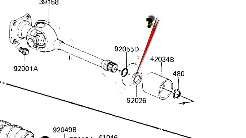

When I took apart the swing arm it didn't have this piece.
When I put it back together there is no play. I can't even see where it would fit as all fits snug.
I don't think I'm missing anything. The gears and everything are like new, so definitely it worked well as is. What do you think?

Without going to the manual to see how Kawasaki wants you to set up the fit of the drive coupling on the shaft, item 92026 appears to be a nominal shim and 92055D is a selectable shim to set the lash of the fit of the drive coupling on the drive shaft. If 92026 is missing I would expect a lot of lateral play between the coupling and the spline collar (back and forth movement of the coupler on the shaft.) Are you sure the spacer isn't stuck to the coupler and you're just not seeing it? Something's funky.

Positively no shim. AND there is no play on the coupling. Hmmm....
I would bet on it my mother's name (if that word is soon allowed instead of parent number 1 or parent number 2? me being first born unit number 1??? - Canadians would know what I'm talking about...), that the swing arm has never been removed. It just doesn't look that way. So, I'd go on a limb and say that shim wasn't inserted there by Kawasaki when manufactured.
It is a funky think indeed, with no lateral movement of the coupling. I don't think I have anything to loose and will keep it as it came.
I wonder if there are some discrepancies in those drawings.

Follow up....
Just removed the swing arm, and what a smooth 10 minutes it was!!
Such a pleasure after it's been serviced. I could do it all day! haha
I removed the grease and took a look again. There seems to be a space where that shim could fit indeed. After pushing in the coupling, the gear edges seem to be somewhat flash from where I look at it, so there could be a shim there - if someone put it there in the first place!
I am still with my first observation that the swing arm has never been removed, so I'd risk a conclusion that it came like this from the factory. I still can't laterally move the coupling, and perhaps that's what the grease packing and a tight o-ring does, but I haven't used vise grips to pull it with a greater force.
I am going to call Kawasaki and see if they have this shim. Other than that, just an appropriate size washer should do the job, as there are no significant forces or movement there. Everything worked fine until now with no wear and tear, and I think after attaching the final gear things just stay in place.

UPDATE! BUsy mornig! Thank you for being a part of this process! haha
Just called Kawasaki and ordered this part. They have it, if anyone wonders. 2-3 business days so I should have it next week by Wednesday. $6.86 +tax Canadian funds.
Hope it fits in! lol
