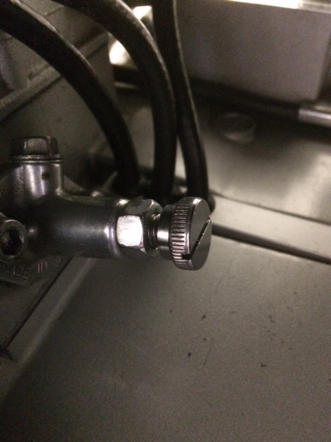

It is definitely a benefit if the CCT bolt and body have a "relaxed" fit - turns easily with fingers. I never did like "their" idea of having A "HEX-head" on the bolt end. Someone somewhere (if it hasn't already happened), is going to wrench that sucker in and .............That's how things get broken !

And only because my mind is on Cuban Rum, Helicopters and bikinis.....not necessarily in that order.....and because I can't focus on work..... I found this nice knurled piece.
Kept my mind busy for 20 minutes and as I indicated earlier - no particular reason - just did it. So the only wrenching you need to do is to tighten the locking-nut !
