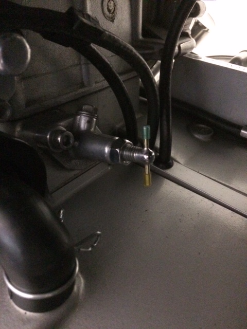

Just a quick response to explain where my asking this question came from: mine is a simple aftermarket tensioner (PSR Manual Cam Chain Tensioner) and I am having a REAL hard time to feel when it meets the resistance. It's quite tight despite pulling the o-ring back and I can feel resistance from start. I can only see when the chain moves just a bit and wondering if that would be 'the point' to keep for further experimenting.
I will practice more with closed eyes and meditation, maybe I will get it by feeling it! lol
- StanG
- Banned
- Posts: 1987
- Thanks: 237
Re: 1982 KZ1300 rescue and rebuild
8 years 2 months ago - 8 years 2 months ago
I don't remember if this is the exact the same one, but looks like this
PSR tensioner
And the end is tapered - not sure if this is a good thing? The oem is flat. Maybe this makes it more difficult to feel by hand. Maybe not good for wear as well. Considering to grind it flat. Any thoughts?
Last edit: 8 years 2 months ago by StanG.
- Kawboy
- Posts: 3248
- Thanks: 1203
If it were me, I'd pull that tensioner off and work the threads between the tensioner body and the screw to loosen the thread up so that you can nicely turn the screw in the tensioner with little to no resistance. Lapping compound or never sieze, just loosen it up. Reinstall and tighten the tensioner by "feel". The old 1965 Honda 150 (C95) I had, used a similar tensioner and it was loosey goosey. Really nice to be able to feel the tensioner as you set the chain tension..
