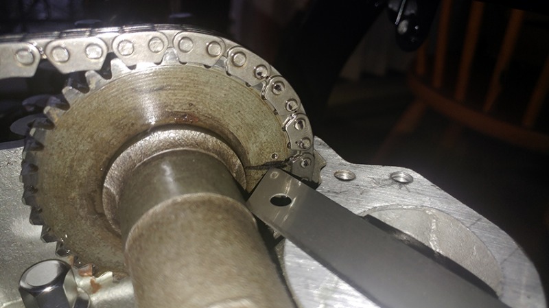

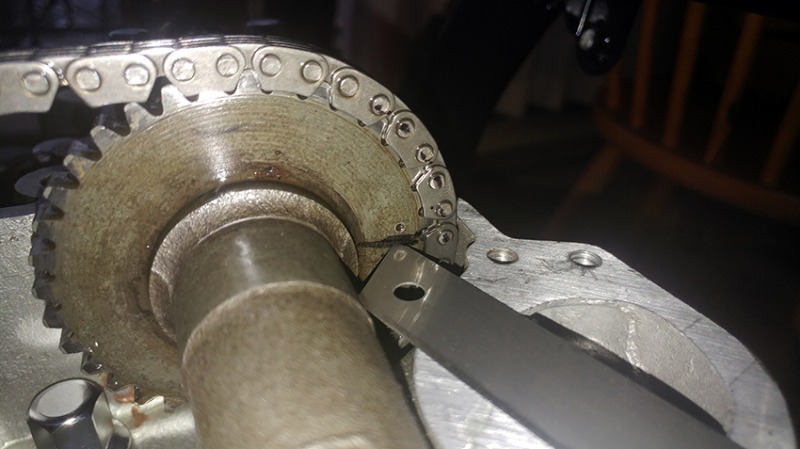

I will post a photo in a few minutes. I chose this position on the exhaust because otherwise from what it looks the mark would be below the head surface, so I chose the next up, like in the service manual and the picture. Then counted 17 on the chain to the mark on the inlet and bolted all down. Now looking back just wondering if all is correct.

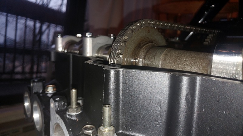

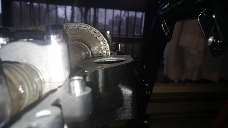

Just so it's clear, I kept the chain tight and turned the crank to align the 'T' mark.
When putting the chain over the exhaust sprocket I kept the tension and aligned the mark as close to the head surface level as possible. The 'T' mark alignment stayed perfectly on the mark the whole time till the end. Had I turned the chain to level better the mark on the exhaust - the 'T' would loose it's place.
So, I guess all is good, or should the exhaust go one space clockwise? But then, the intake mark would be above the head level, but that's in a way is irrelevant because the number '17' is what's important. (thinking aloud..)
So, again, the question would be - is the exhaust the way it is set properly or should it go to the right?

Under the circumstances Stan, I don't think you will get it any better than what you have. This whole camshaft drive system relies on a drive chain between the crankshaft and the secondary shaft and then the camshaft drive chain. Any slack in the primary chain will add retarded timing to the set up and the same thing with any stretch in the camshaft drive chain.
Judging by the pic, you almost have enough slack in the chains to advance the cams one tooth but then the cams will be advanced more than if you had new chains in the engine. It would be close and you could only confirm this with a dial gauge. There's 36 teeth on the cam sprocket. A change of 1 tooth on the cam equates to 10 degrees cam rotation or 20 degrees crank rotation. Without being able to measure your setup with a dial gauge and judging by your pic, I would guess your somewhere around 12-15 degrees retarded. That dot on the cam is just to indicate which tooth tip is to align with the top of the engine. If you advance the cams by one tooth in your case, you might be ( a little math here) 12-15 degrees retarded + 20 degrees advanced = 5-8 degrees advanced. This situation is unique to the KZ engine because the cams are being driven off of the secondary shaft. Most engines drive the cam off of the crank for obvious reasons.
