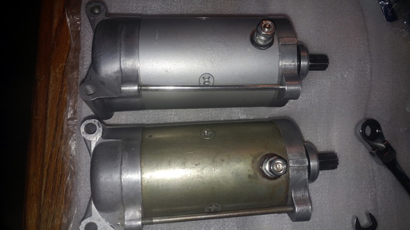

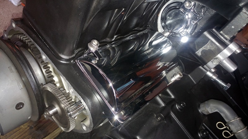

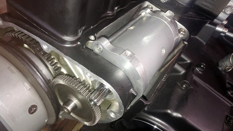

Some more progress today:
This is the original starter which was completely stuck solid and rusted and I rebuilt it. Tested - works like new!
But I'd like to point out a very important information for anyone rebuilding these. Align the marks on it precisely and correct! In my ignorance I had those lines off by about 5 mm, and when tested - it didn't move! Just a spark and looked like a short. Thinking maybe internally things are broken because of all the previous rust, I went on eBay and purchased another one. The seller even posted a video especially for me to show it works. A very nice seller. So I got my new starter and looked at it closely. Then went back to the service manual and confirmed the alignment of my original one was not right. I corrected it right away, and boom! It's alive!! So, this is the one installed now. In the meantime, I opened up the new arrival and cleaned it up internally, put some new grease, removed carbon etc. . So now I have a spare good starter motor. I think I will paint it later.
