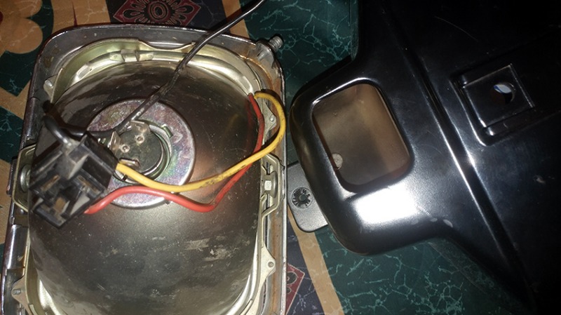

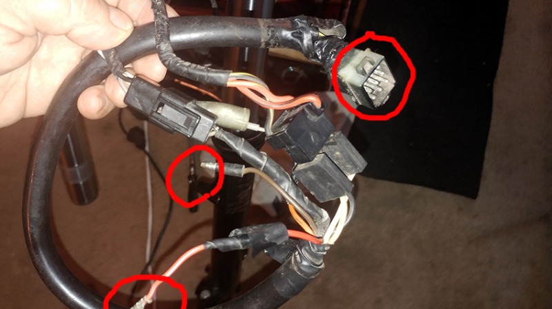

Here I am left with these connections open, and I can't fit them anywhere. I think these are meant as direct hook up for the headlight, right?
What are those two single wires for? The red and the brown? Does this whole part of the harness fit inside the light bucket?
I sourced this headlight with a bucket from eBay, and the connection here looks totally different. What am I missing?

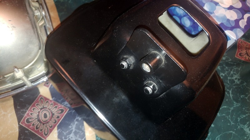

Is this where the bucket is attached to the headlight adjusting assembly?

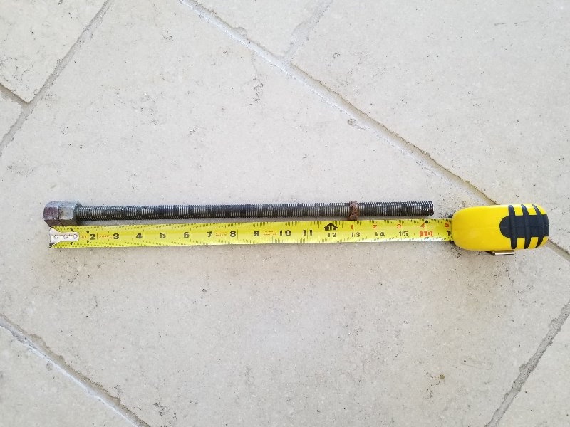

I know its a late reply however this is a tool I made up in 1980 to do my forks with it a 5/8's threaded rod with two 15/16 nuts tightened against each other and I held it from moving using vise grips

there are other models of KZ's (550, 750, 1000?, 1100) that used the rectangular headlight are you sure the one you got was actually off a 1300 or did they say it would fit a KZ1300 ( just asking not trying to be a smartass.) could be that's why the wiring is different.

looking at that harness again it maybe a harness used on the Kawasaki fairing that used the headlight (the big boxy looking one that said Kawasaki on the sides) to go between the fairing and the bike

I am going the same route with making my own tool stocktoy. The copper tube method let me remove one on the right side, so now I have it in my hand as a sample. The piston is in my backpack and I will be hitting the hardware store today to make a correct fit without guessing and have a tool for removing the left side and then tightening both.

It also crossed my mind that this harness piece is for some fancy accessories or just a fairing. It has 9 pins. So... I don't know which wires I need, what should I cut off (if that's what should be done). So far I managed to connect almost all the connectors I had, so whatever the bike came with is partially sorted out. Next the tail light and the rear turn signals, then I will do the front. And the coils still to sort out. I have three AW82 now, but two of them a bit lower resistance than 2.4, and one 2.4. The guy at the shop told me I should be good, but I still want to sleep on it before mounting the coils permanently.
The headlight and the bucket were advertised as from KZ1300. Maybe a different model? I had to buy the rubber dumpers and collars and they fit perfectly. Either way, I will have to utilize them. Just have to work on it since I will be using alternative ears for now.

Yeah, I see what you mean (sorry, missed it first). I would agree - it looks like something that would go further forward to reach a headlight in a bulky fairing.
