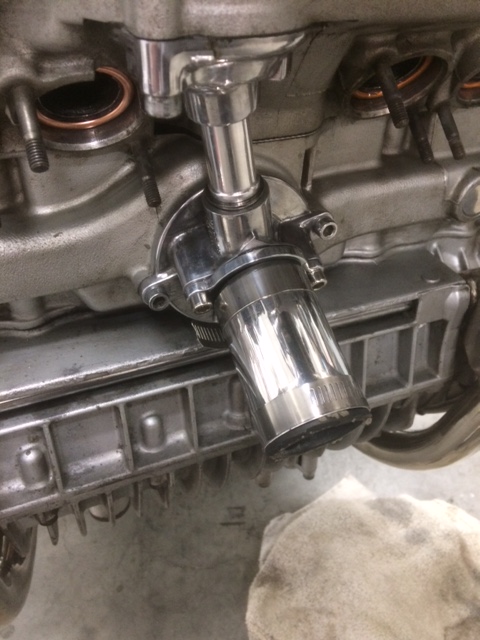

StanG - There I was, perfectly happy - Then you had to show some of your polishing skills ! So I "see" your thermostat housing and "raise" you one water-pump assembly ! .....and no, I did not polish the impeller ! I did polish the inside of the water-pump inlet to improve flow An academic point probably !
Regarding the #1 and #2 embossed on your two mechanical seal holders. You've indicated they are identical and no reason to doubt this as I expect you "mic'd" them. Perhaps they identify the factory casting molds (?).
Now I've got to get the header and radiator back on ASAP before I do something stupid.....like polish the impeller....for academic purposes:woohoo:

Scotch, that water bypass pipe looks immaculate! Now I have to double check on mine... That top shiny housing I have is hard to beat though. I have to confess - it's chromed! haha
And I also polished the propeller. In a way. I used the same cloth I had impregnated with metal polish compound to give it a final removal of any oxidization. It's well deserved after sitting in rain for who knows how many decades? I can't put anything back together anyway, I need my itchy fingers get some scratching, LOL
For academic purposes, one could wonder what give a better flow - a smooth polished impeller or a rough one? A polished one would help with the flow, but a scratchy one would have those hundreds of tiny 'paddles' grabbing more water molecules and thus increasing the volume? I think we should compromise: polish the vanes curvatures, but keep the base rough!
Yes, those two mechanical seal retainers are identical, except for the numbers. Actually, the '2' was on my bike but I used '1' from the block I got off eBay. Someone just filled the whole thing with black silicone, so I know the bike had leaking issue. And after the 'repair' I am sure it only got worse, because that specialist also plugged solid the weeping hole. The silicone was a bitch to remove so I just used the clean one.
The bottom hose I am replacing with a beautiful high temperature sky blue silicone. You know, blue for water
haha
I love your stainless clamps there. I have the same
