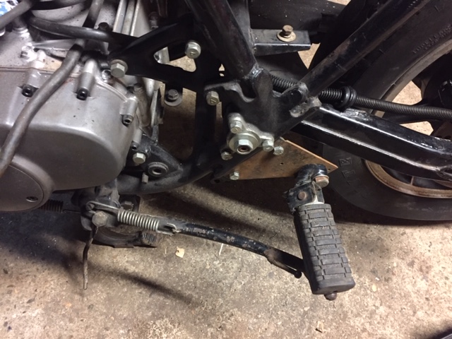

I was trying to sit on the bike to see how I fit and came to the conclusion that really I ought to put the foot pegs further back. The pegs in the standard position cause me to curl up too much.
So I took the aluminium rear peg and exhaust supports off and fashioned a mock-up bracket to try it out. The seating position is now great, but here is what happens if you start messing with the standard design:
Bearing in mind the centre stand is due to come off, I need the side stand... but really that now needs to move or be shorter or... ? Well... suggestions welcome!

Start by straightening your side stand, then find the final position for the rear-sets.
Think twice about removing the center-stand. There are simple ways of modifying it. Keep in mind a scenario such as a flat tire and how you'd remove a wheel with just a center-stand !

I may be jinxing it, but I have never had a flat tyre in my 30 years of bike riding, and only one or two in my cars. I will only be riding in and around London and have a good network to pick me up if I do get a flat. I'll take the risk, Including the bar holding it away from the swingarm the centre stand weighs a ton and removing it will give me more room for the exhaust pipes.
I will indeed start with straightening the side stand and then play around with the peg position. I may also use a different peg - less bulky.
If all else fails, I may look to get this one off and put another one on, a bit further forward...

I have been looking at universal clamp-on side stands and I have decided I really don't trust them. They all seem to be too short and flimsy, and bolting onto the frame I think will not work. The bike is so heavy the clamp may just slip. Also, the clamps are all 30mm in dia and the frame dia is much larger....
anyway...
Upon further and closer examination it seems the bracket is a half-moon welded at the top and at the bottom.
That means I can easily grind those two welds off and the bracket should be eminently re-useable, which means I can move the whole thing forward about 19cm and weld it onto the frame just behind the front bottom engine mount.
And when re-welding I can slightly turn the bracket so that the stand folds closer into the bike more - even after straightening it - leaving me enough space for a new rearset foot peg/gear lever set up.
Only issue is that this can only be done when the engine is out of the frame and I was not anticipating doing that until it was fully built-up and running... which means the centre stand needs to stay - which means the exhausts cannot be fitted.... which means it won't be up and running...
.... so I may have to take the engine out once more before building it up completely..
[sigh]... did I say all good fun??? Ha!
I'll have to think about this a little.
