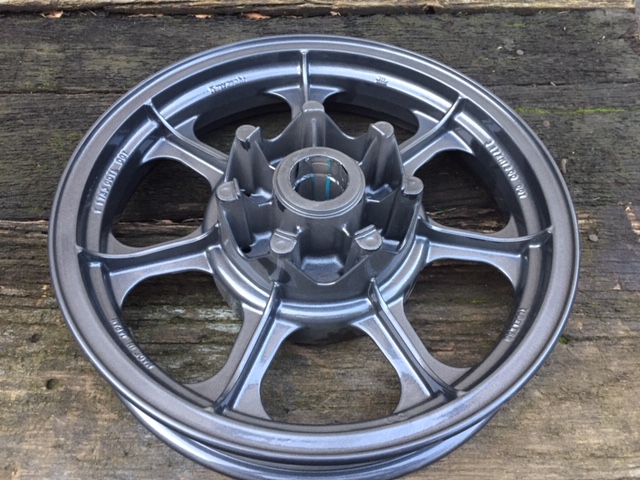

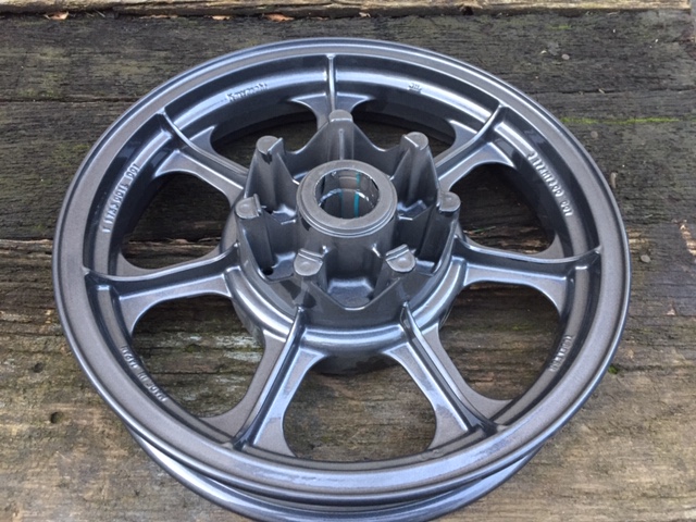

I managed to use one of the new seals and the new 'top hat' rubber gasket from the front MC repair kit, and the rear MC seems leak free. Result. I have also repainted it and it is ready to be fitted.
In the meantime, the powder coater has managed to powder coat the rear wheel in the same shade as the new front wheel - anthracite grey. Looks great! Ready for new wheel bearings and brake disc.
Gotta decide on tyres now... I'm thinking front: 120/80/R17 and rear 150/70/R17. Michelin Pilots seem to come up in every test as best.... ?

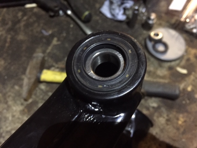

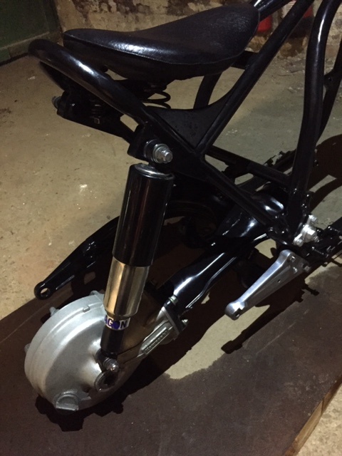

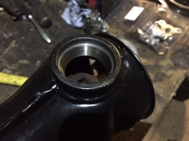

Update; cleaned the swing arm pins, inserted bearings and re-installed the swing arm (see other thread). Also re-attached the final drive and one shock to keep the whole thing together.
Now awaiting top yoke and tyres to build up the front end, and then I can slot the engine back in to the frame.

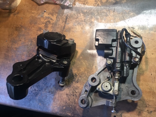

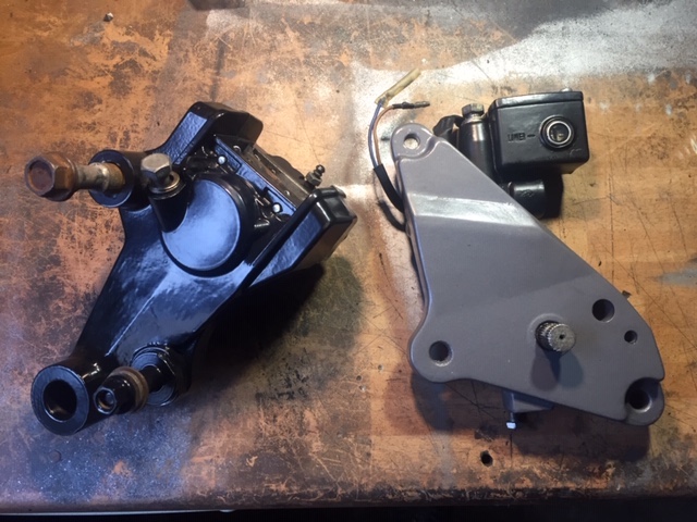

Rear Brake caliper, shot blasted, powder coated with new piston rubbers, ready for installation, alongside the refurbished MC plus mounting plate.
