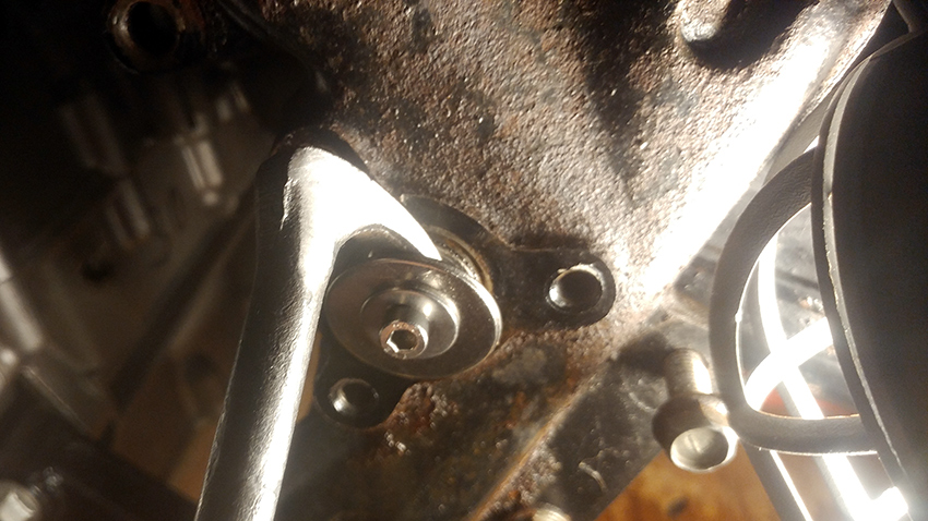

Still kind of confused with your pivot extraction... Hmm.. In the pic is what I did - you could jam a 'fork' or two pieces in there and screw that bolt in pulling the pivot out. Did you work from the inside?

well... I sort-of didn't think about it. I realised they were around and settling on the engine, but what I had not anticipated was that the space was so damp! Anyway, sorted now. I did have the engine sealed, so no particles got it, that I am sure of!
Yes, I had the engine and drive shaft out, so I could work from the inside and push them out using a bolt, a nut and a washer. Bolt head against pivot, washer against the hole that goes into the swing arm. Then screwing the nut out against the washer, the head of the bolt pushes the pivot out in a very controlled manner. The other pivot could be tapped out from inside the frame when the swing arm dropped out after removing the first pivot.
It really did not take me more than 15 minutes for both! I guess I was lucky, but I definitely prefer pushing the item itself than pulling on a thread inside the item.

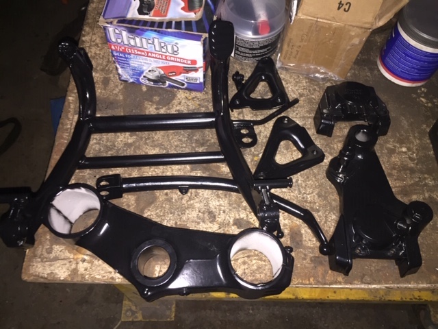

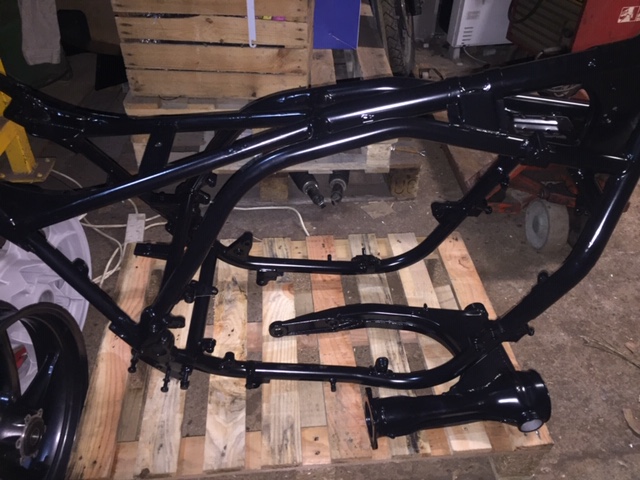

Another milestone: frame and ancillaries powder coated... it looks glossy, but actually it is satin black.
I can start rebuilding now!

BIG STEP!! I'd say that's the top of the hill. It's going to be emotionally easier from now on, as it will be adding on rather then removing.
