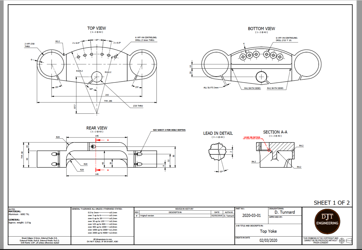

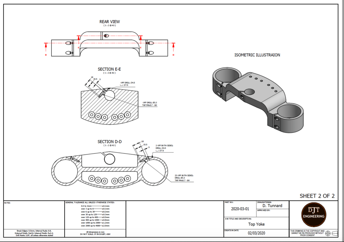

Its been a while since any progress has been made.
My tyres have still not arrived, but finally I have had the drawing of my top yoke back. The guy (I found him on peopleperhour) did a fantastic job of interpreting my rough drawings with measurements into a proper tech drawing. Based on that he also created a 3D CAD file which can now be used to mill a block of aluminum (or steel) to create my bespoke top yoke. Benelli front suspension and bottom yoke married to a bespoke top yoke through the original Kawasaki steering pin.
Once I have the yoke and the wheels I can progress the build again...

6 years 3 months ago - 6 years 3 months ago
Ugh! Cheapest quote to get this machined was USD380 from a firm in China. Cheapest UK quote was over £400!
That is NOT in the budget, so now going to experiment with existing yokes. I have got a cheap one from an MV Agusta 750 which looks likely to fit with minimal work.
In the meantime my new rear tyre turned up (front still not in stock). I got it mounted and balanced (and annoyed as they chipped my new powder coat!) and got it onto the bike. This is a Bridgestone Battlax BT45, 150mm wide, and if you look at the pics, these fit the swingarm fine with at least 1-2cm clearance.
Once the front tyre arrives and I have sorted the triple tree conundrum (see other thread), the engine can go back into the frame and then it will start looking like a bike again.
