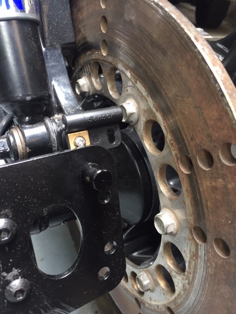

The issue will be where to mount the sensor, but I’ll have a look at that too.
I still favour the front wheel apart from the cable issue.

I put a magnet in one of the holes in the rear disc & hid the cable for the sensor on the underside of the swing arm. You can extend the cable, it will still read OK. I put the sensor on the forward edge of the brake caliper, so again, you can't see it. I had the same model of Acewell as you before, they're good units, I only changed it to a model with a needle tacho as I found it difficult to read the digital segments on the tacho sometimes. For setting the speedo up I got it in the ballpark, then attached a sat nav to the top of the tank to get an accurate speed then fine tuned it that way. I set it so that it over-reads by about 3 mph, as most speedos do.

Ok, decision made; rear wheel, magnets on the disc bolts and the sensor attached to the licence plate light bolt. When the licence plate goes on, it will hide the whole thing. Pulled a new black wire to the front and you can't see a thing. Happy!

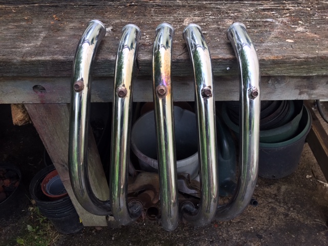

As the process for finding someone for the exhaust build has stalled, I cleaned the pipes that came with the bike that I initially had written off as rusted and broken. They came up surprisingly well and there are only a few small holes that I can easily weld shut. I think I'll hang those on once I fitted the final missing pipe that I will getting tomorrow and at least I have something so I can trial start the bike. The system has collector boxes, but they are rusted out inside, so it will still be loud!
