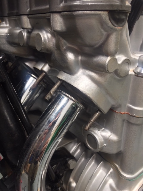

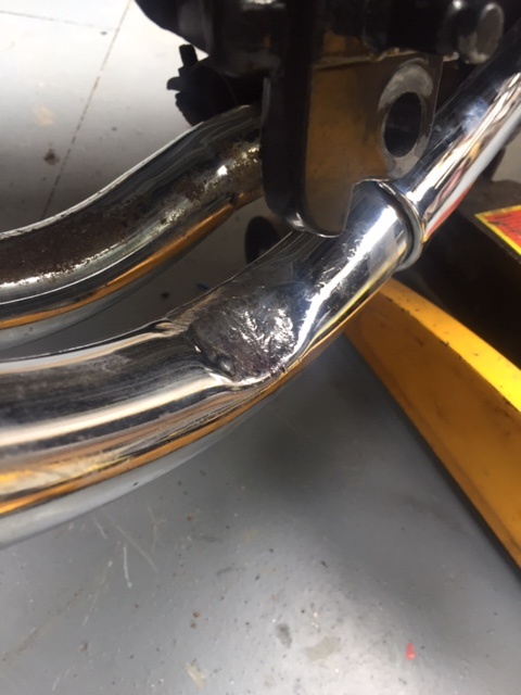

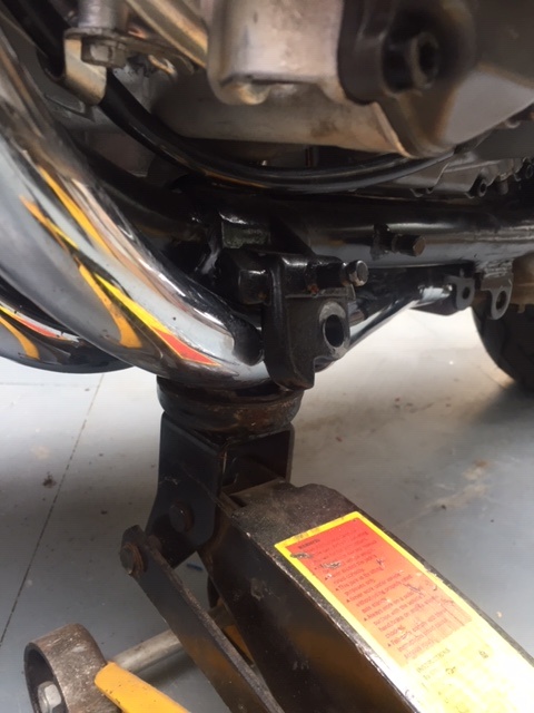

In the meantime I test fitted the exhaust and ... surprise surprise! .... another issue popped up:
... and how I solved it!
Yes, I bashed the pipe in to get round the side stand bracket which I obviously welded a little too far forward - but how was I to know? Of course I know now for the next time, and for this bike I will get a completely new system anyway.
The old system I have is fairly damaged, needs a lot of welding to plug all the holes and will only be on the bike until I can get my custom system fitted and then will go on Ebay for a fiver or so...
Cheers
Paul

The good old exhaust fitting process on a Z1300............I have learned many new and offensive swear words doing that over the past 40 years !!!
I too have resorted to the JACK idea with good and bad results, especially if you intend to fit the centre stand.
