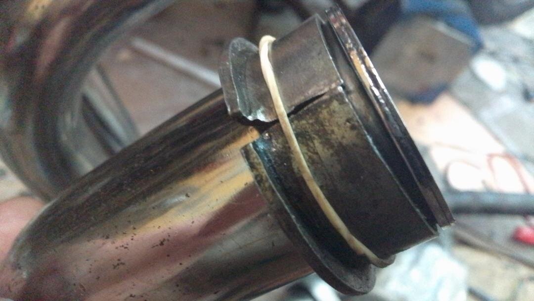

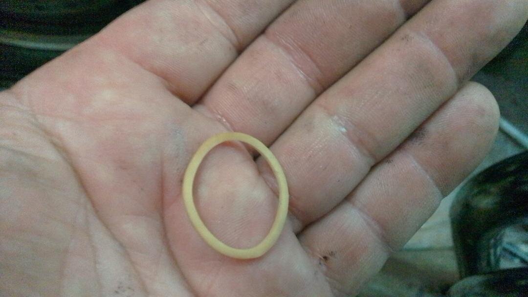

After weeks with the project on hold, today I decided to put laziness aside and went down to the garage to spend some time pampering Christine.
It had not breathed through its original airbox for many years.
Again he has a tool tray, his money cost me.
Assembling the exhaust manifolds drove me crazy, too many loose parts for so few fingers to hold.
In the end I had an idea and it worked for me.
I used rubber bands to hold the plates that hold the mouth of the exhausts.

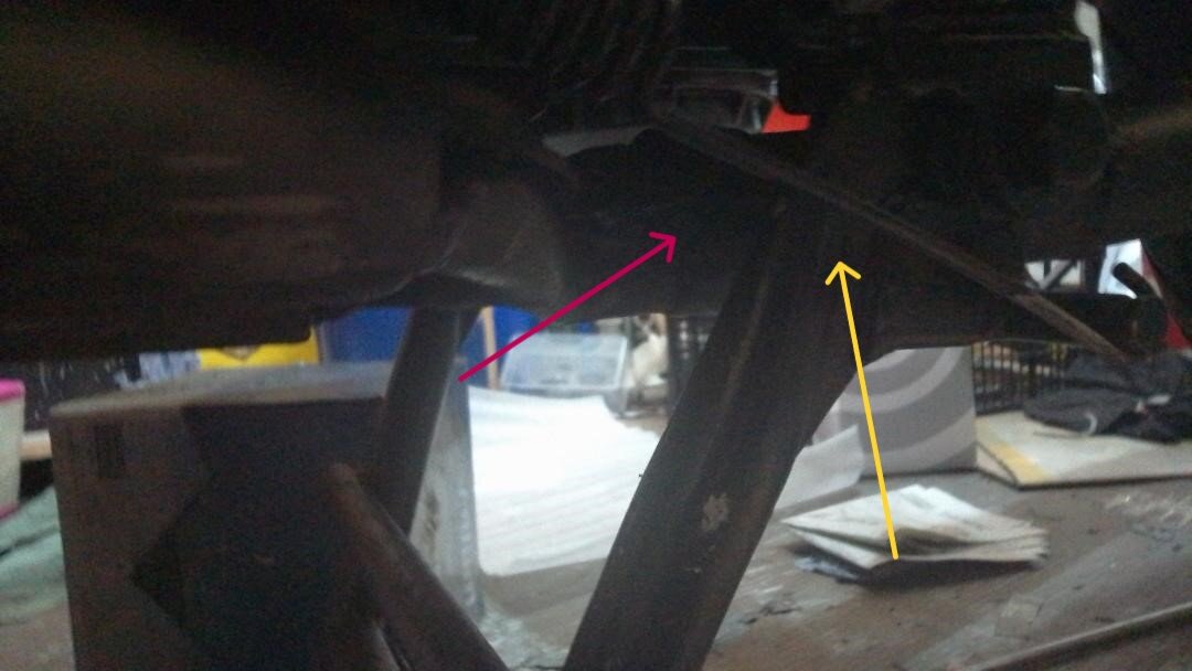

Everything made sense again and worked wonderfully until after trying without luck to tighten the manifold nuts, forcing the tubes, I realized that I had to disassemble everything again and insert the exhaust outlet inside the main stand structure.
I had mounted them outside the main easel and there was no way to fit them into place.
