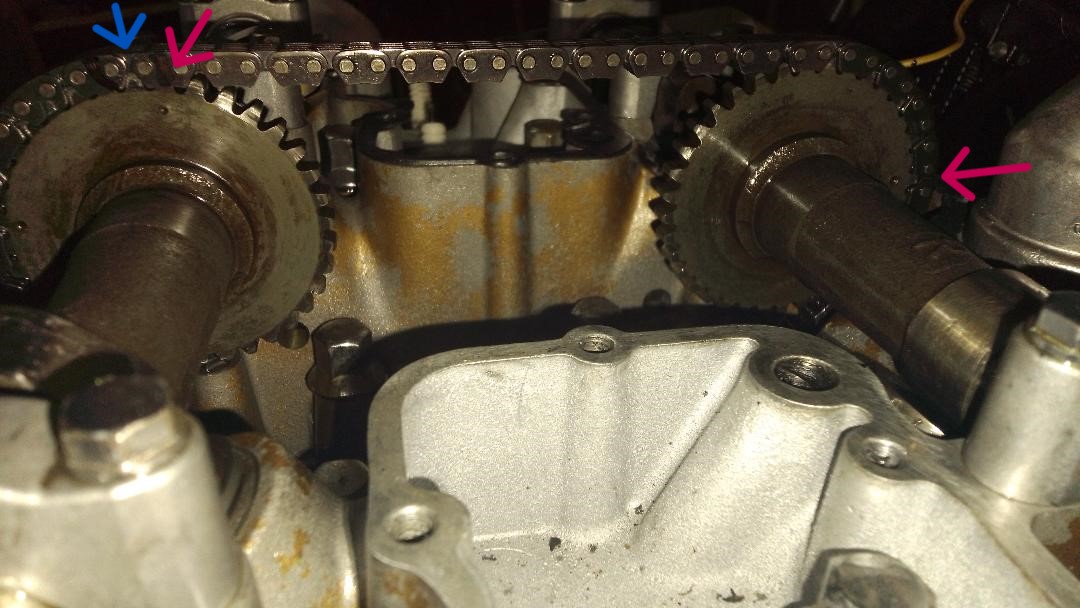

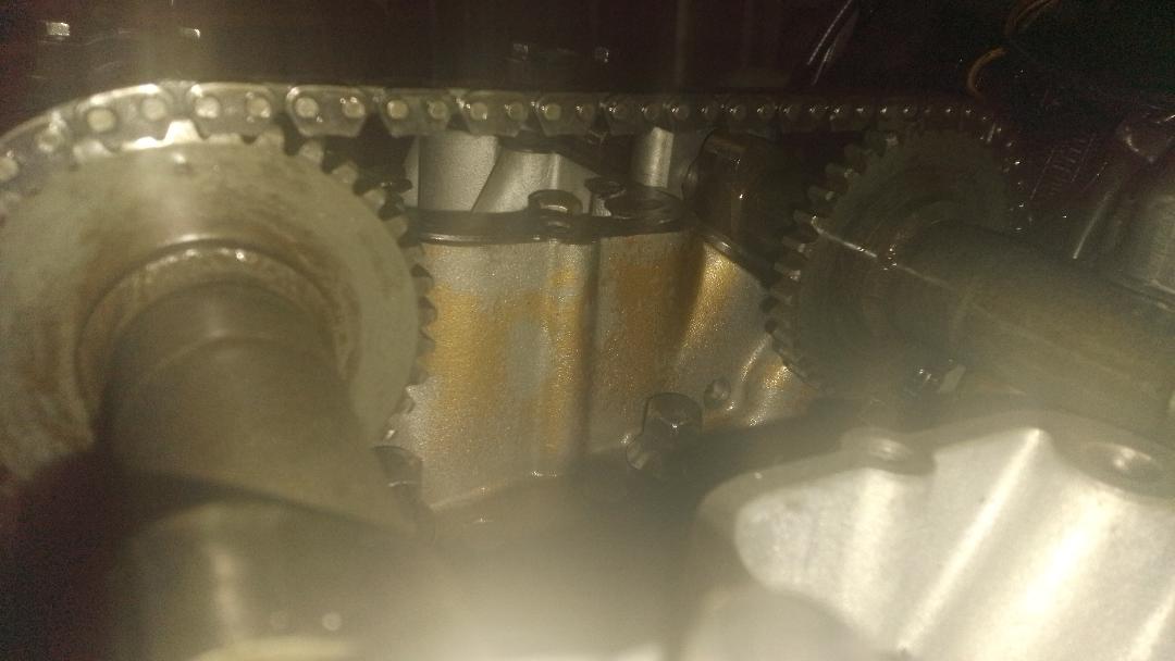

This week I received the calendar of motorcycle and classic vehicle meetings so I thought about getting my hands on Christine again so I could present her in public as another of my collection girls.
I left it on standby in July, before the holidays, so I started where I left off, reviewing the timing chain tuning and the camshaft notches.

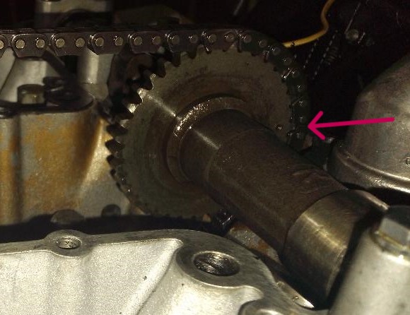

To my surprise, the intake valve shaft was one tooth advanced from where it was supposed to be after counting the 17 links of the chain.
The intake valve camshaft is correctly in place.
The intake valve camshaft one tooth forward.
The blue arrow indicates where the sync point should be.
Once the problem is solved, everything is in its place.
Now I have checked the valve timing and adjusted the shims in the intake of cylinders 4 and 6, their tolerance was 0.03mm and I left them at 0.05mm like the rest of the valves.
The exhaust valve on cylinder 4 was at 0.06 and I have adjusted it to 0.10 like the rest of the exhaust valves.
Next I checked the compression of each cylinder.
To my surprise, cylinders 1 and 4 have ZERO compression, while cylinders 2,3,5 and 6 give values above 130PSI.
I have poured oil into cylinders 1 and 4 to rule out a piston ring problem, they are still without pressure, the problem is with the valves.
Now I have where to start, I have left the radiator drain plug open to drain the coolant, next week I will remove the cylinder head and see how the valves are, if they are bent or pitted by rust like the ones I changed in the first repair a year ago.

Bent valves for sure . I just counted the links in the picture and I count 15 1/2 links so the intake cam is 30 degrees crankshaft advanced from where it should be. In the firing order 153624 153624 1 follows 4, so no surprise to hear 2 bent valves in sequence.
Rusted pitted valves would give low readings by a small amount. Zero compression is a gross leak.
I'm surprised that you managed to get the shims reset to proper clearance. A bent valve will hold the valve open and usually, you can't find a shim thick enough to fill the excessive clearance.
