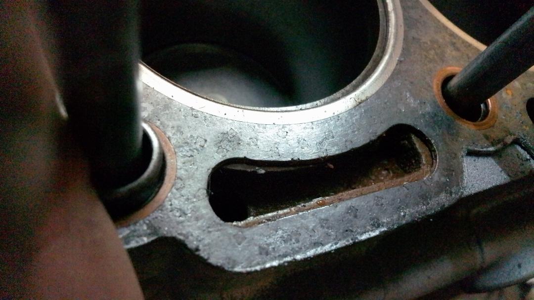

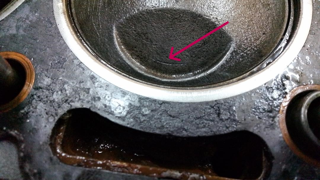

When I have something in mind, I don't stop until I do it.
This afternoon I sacrificed my snack and locked myself in the garage to continue disassembling Christine.

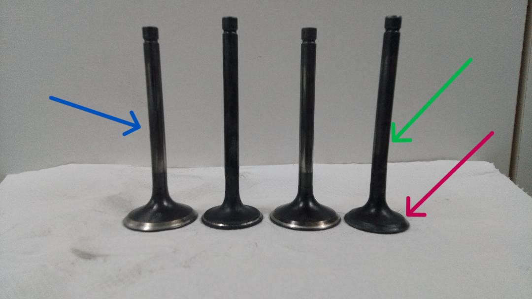

I already have the cylinder head off the engine block.
At a glance I noticed a small notch in cylinder one caused by the exhaust valve impact.
Without going home for dinner I continued with the task and was able to disassemble the valves on cylinders one and four.
On the left the intake valve of cylinder one has a bent stem (blue arrow), the exhaust valve has hardly any damage.
On the right of the image the exhaust valve of cylinder four also has a bent stem (green arrow), the seat is full of carbon as it does not close tightly (red arrow).
The intake valve of cylinder four does not seem to be damaged.

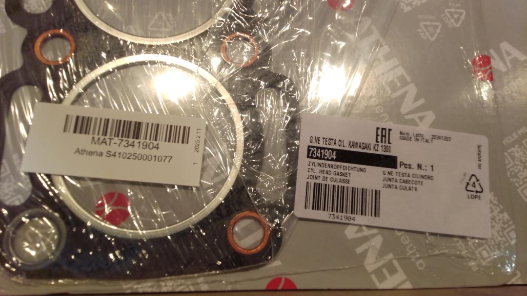

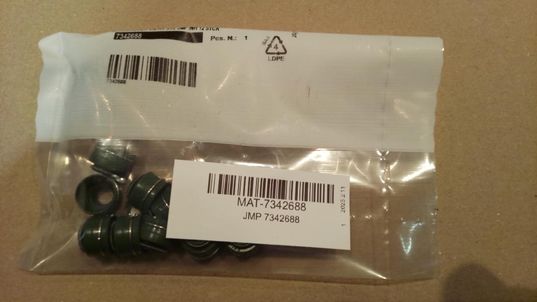

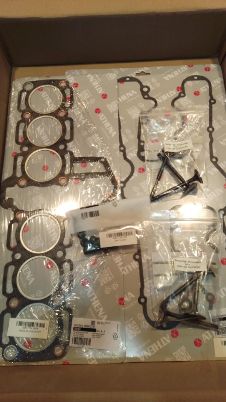

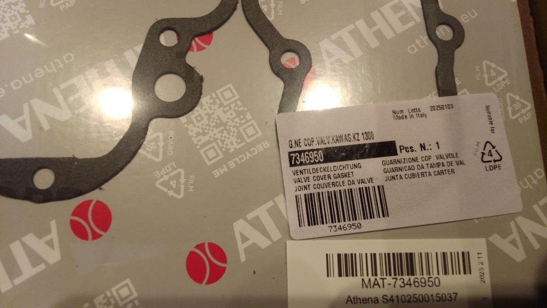

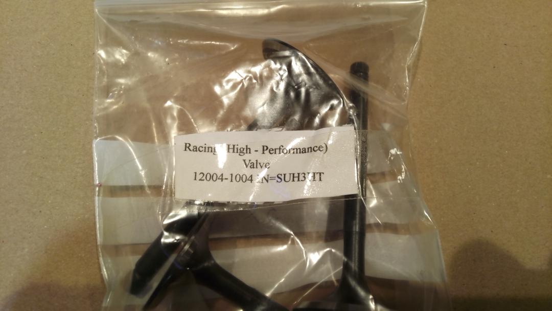

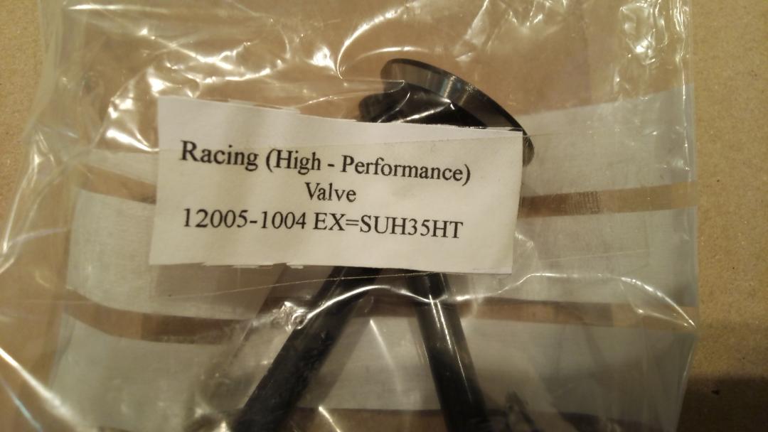

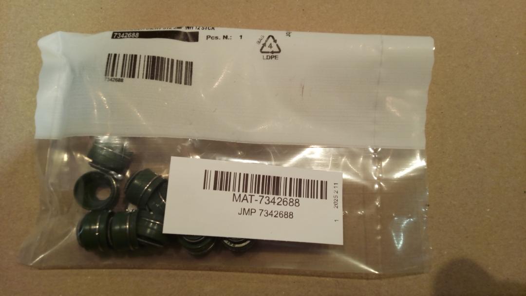

This week I received the parts I bought at
GETOR.
Cylinder head gasket
Three inlet valves.
Three exaust valves.
Set of valve seals.
Cylinder head cover gasket.
This coming weekend I'll get to it.
Three inlet valves.
Set of valve seals.

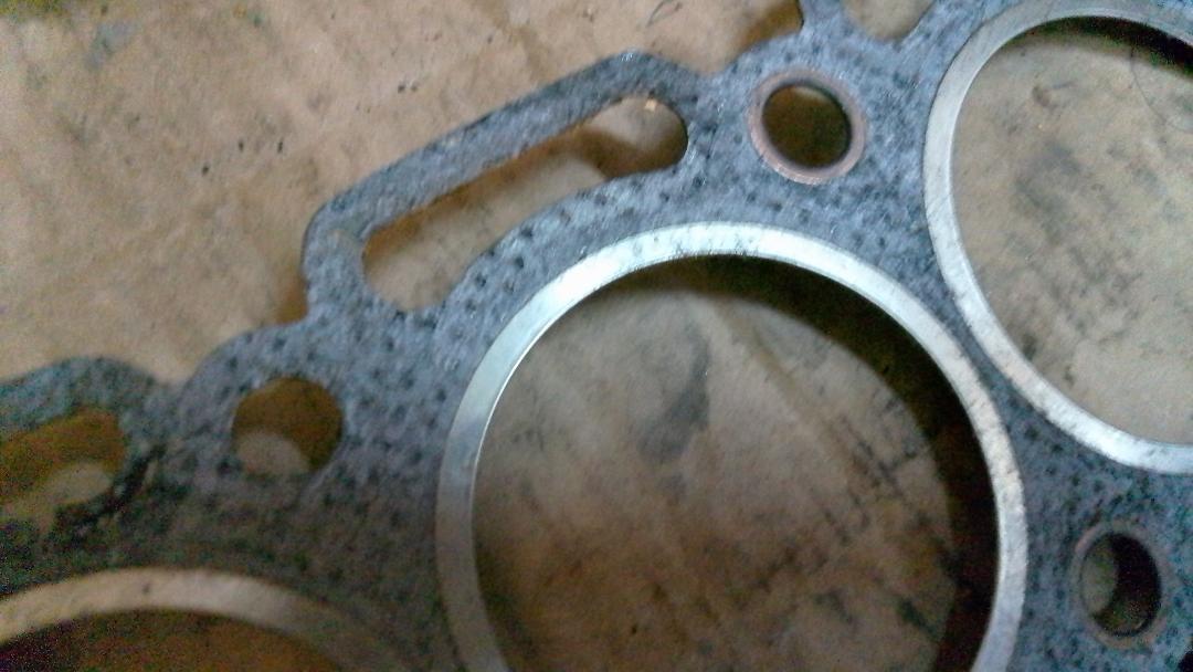

I am curious as to how the Coolant Passages on this head-gasket, seal. Kawasaki OEM H.G.'s and some others have a sealant bead on both sides. I see none on this gasket. Are there specific instructions regarding this?
Always High - Know Fear !
Last edit: 1 year 4 months ago by scotch.
- kawaBCN
- Posts: 384
- Thanks: 147
Re: THE MOMENT OF TRUE.
1 year 3 months agoWell, to be honest...I am curious as to how the Coolant Passages on this head-gasket, seal. Kawasaki OEM H.G.'s and some others have a sealant bead on both sides. I see none on this gasket. Are there specific instructions regarding this?
The gasket that came with the engine after being rebuilt by the former owner when I bought the bike had no sealant.
When I overhauled the engine I bought a set of Hi'Level engine gaskets from a UK distributor and the cylinder head gasket also had no sealant.
What I did then was to smear some silicone gasket sealant all over the gasket carton with my finger.
Okay, yes, the engine didn't run more than 60 km, but there was no indication or sign of coolant leakage.
