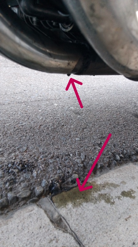

Another issue to check is the oil leaks. It looks like a gay pride parade float every time it makes a stop.

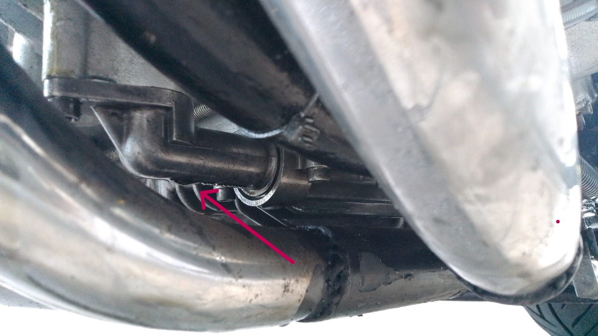

That oil leak looks like its th e O-ring on that pipe shouldn't be hard to fix if you can get the elbow out without taking the exhaust off.
- kawaBCN
- Posts: 384
- Thanks: 147
Re: THE MOMENT OF TRUE.
1 year 10 months agoI replaced the o-ring, and all the other gaskets, when I assembled the engine.That oil leak looks like its th e O-ring on that pipe shouldn't be hard to fix if you can get the elbow out without taking the exhaust off.
I will check the tightening torque of the screws.

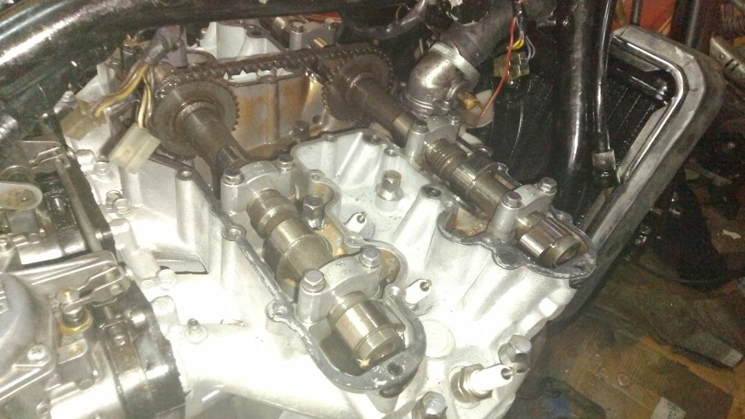

THERE IS SOMETHING THAT ESCAPES MY UNDERSTANDING.

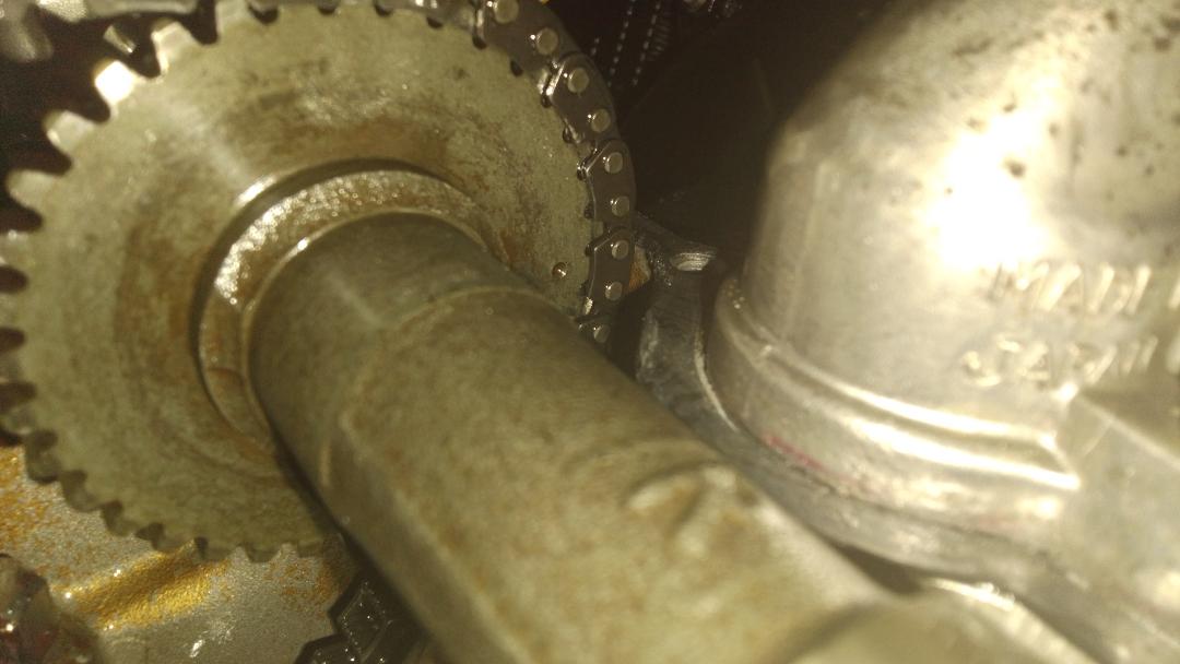

I sacrificed my Sunday at the beach by staying in the garage with Christine, I removed the valve head cover.

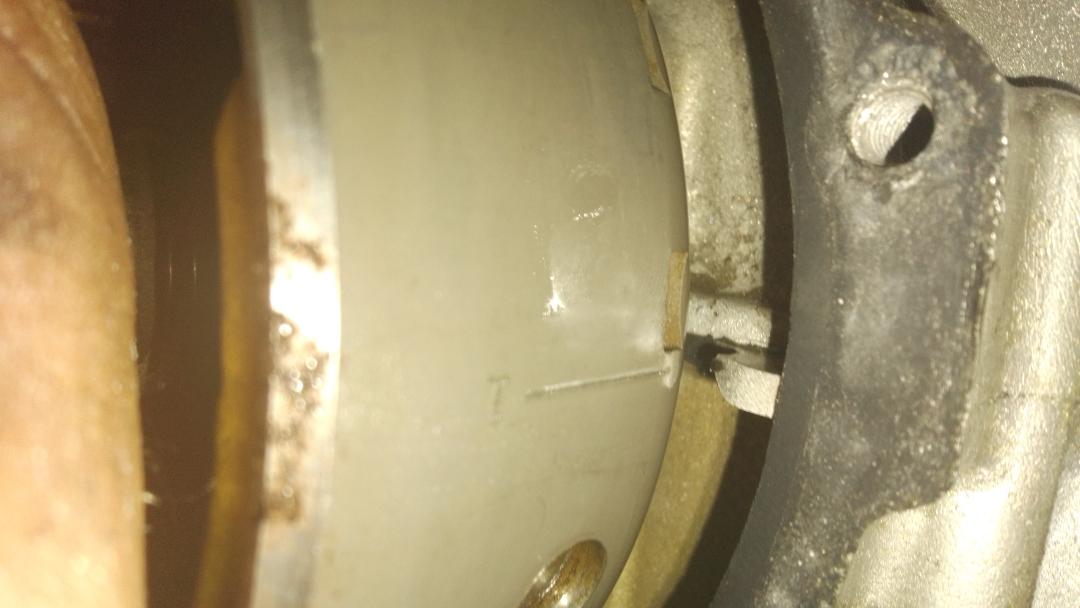

I advanced the timing depth one tooth, focusing its reference points as much as possible.

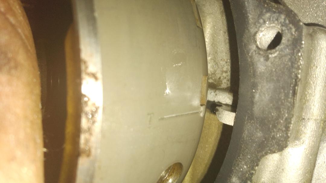

I also drained the oil pan to remove the alternator cover to see the crankshaft timing marks.
I checked the valve clearance, everything was correct.

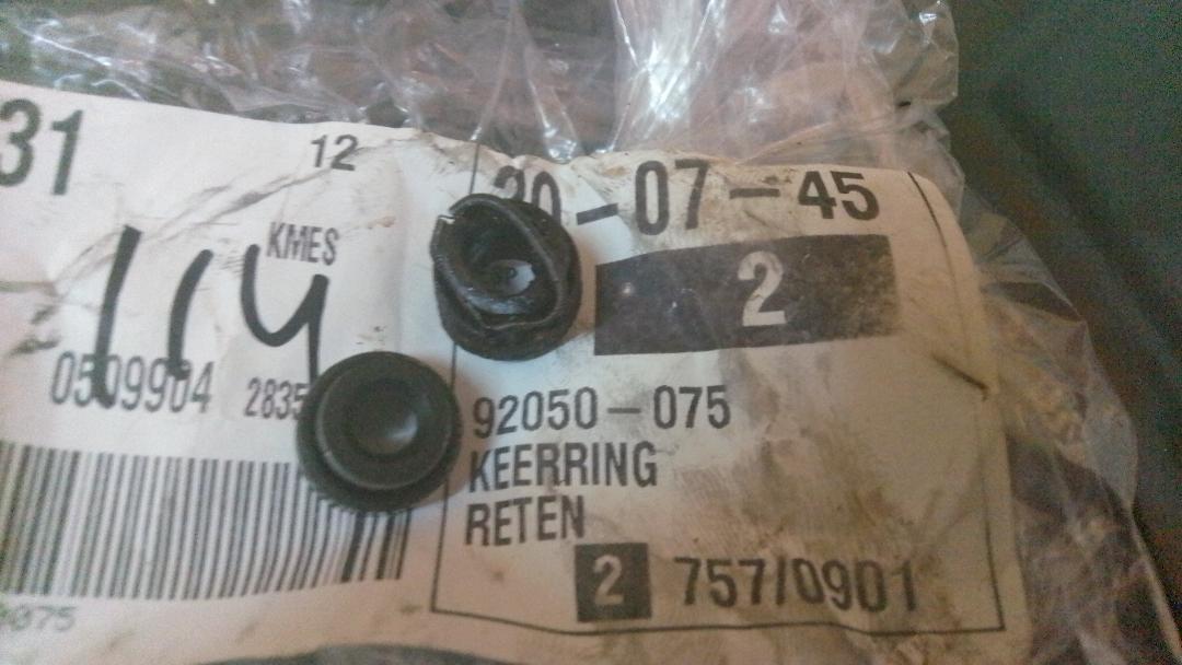

I reassembled everything again, I took the opportunity to change the tach seal, it is the same reference that the KZ1000 and the KZ650 have, I have some spare parts at home.

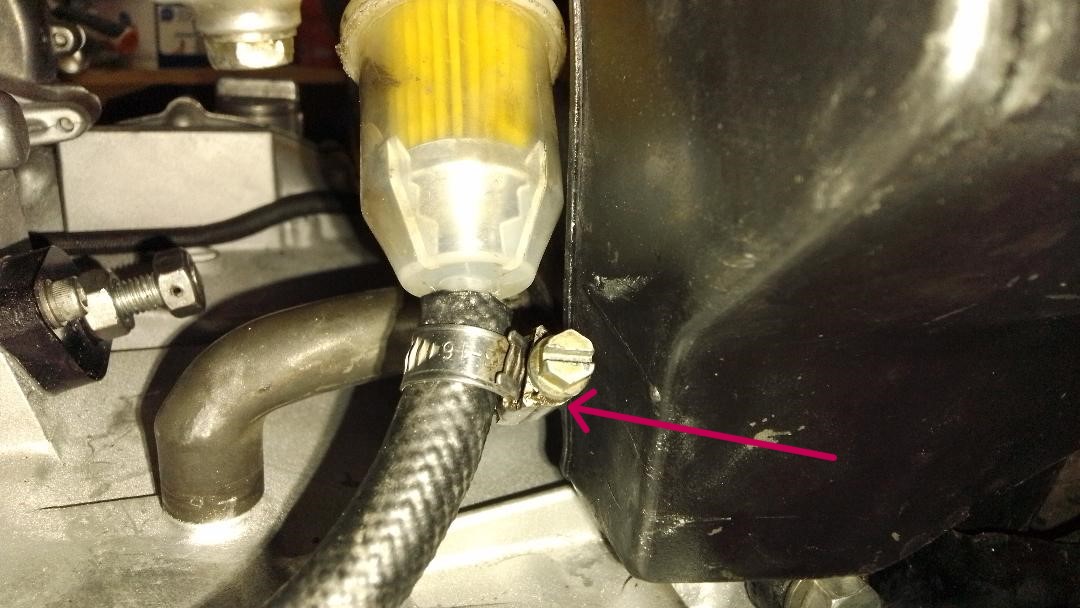

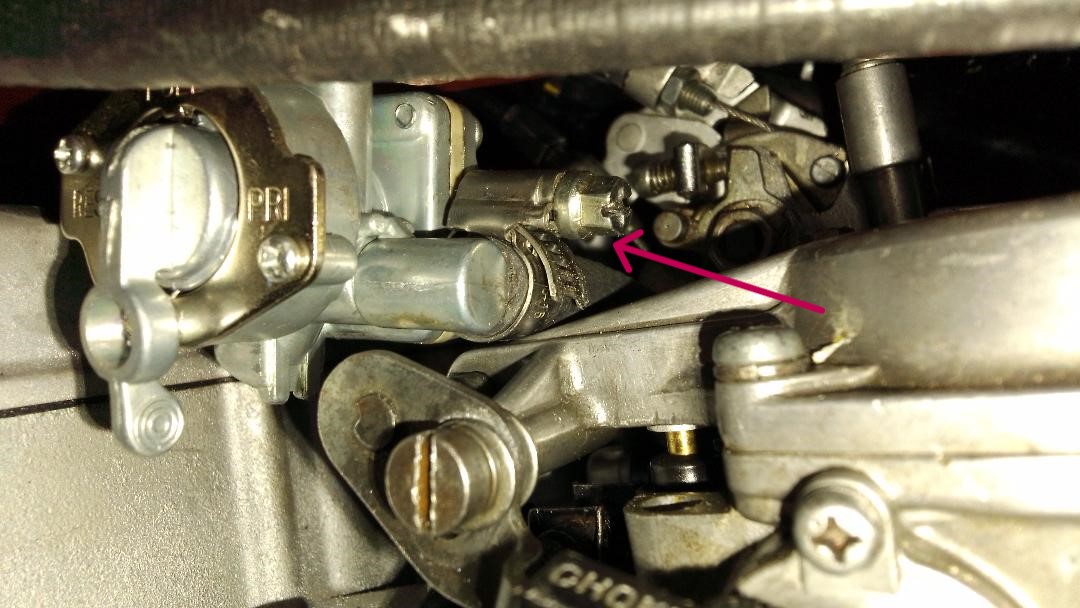

I have gained some practice when removing the fuel tank, I don't pinch my fingers trying to remove the tap flange in such a small space.
I take out the flange of the gasoline pipe that feeds the filter, it is under the carburetors and I can fit both hands without a problem.
I disconnect the fuel gauge cables, the vacuum tube from the intake manifold and simply pull up the tank.
The bike starts on the first try with just a touch of the button, it sounds softer with the advance of the timing that I adjusted today but...
It keeps making a damn clack-clack-clack when accelerating sharply...
The next step is to look for the source of the fucking noise with a stethoscope.
