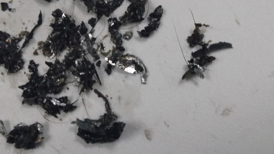

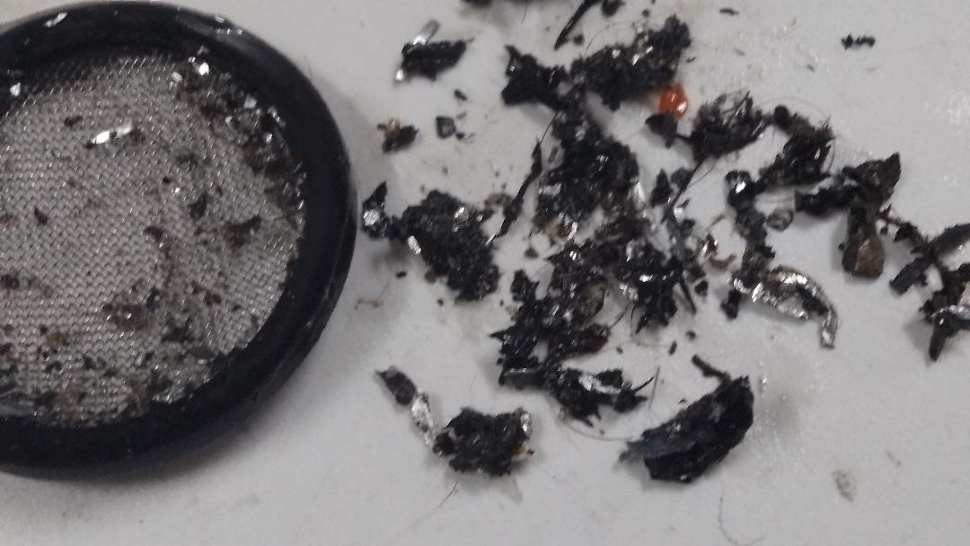

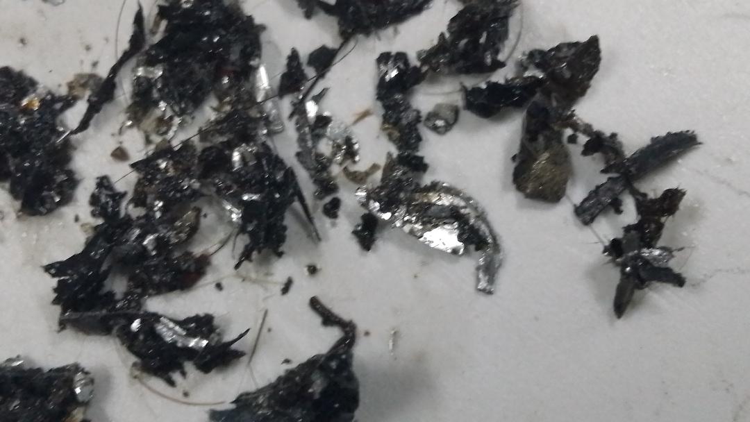

Today I filtered the oil I had drained from the engine crankcase after riding a whopping 15 km.
The filter was filled with silver flakes and black silicone gasket residue.
If I had found a couple of coins it would be like cleaning the washing machine filter.
It is clear that I have to disassemble the engine again, some moving part has friction with the alloy crankcase, it scares me to imagine how shitty the oil pump filter screen will be.

1 year 10 months ago
Are you sure it's black silicone gasket sealer and not black rubber nitrile from possibly the tension roller on the cam chain tensioner?. that would make perfect sense after hearing the Youtube video.
