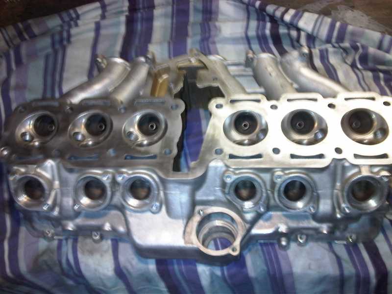

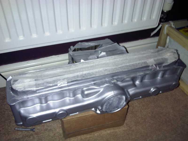

TOP END REFURB UPDATE 16th NOV 2013.
Cylinder block fully prepared now, liners de-glazed & fully cleaned & spray painted in (Silver Smooth Hammerite)
Cylinder head completely stripped, had its bath of petrol for a week & fully cleaned ready for paint.
Next job is barrels & pistons back on with new rings.
