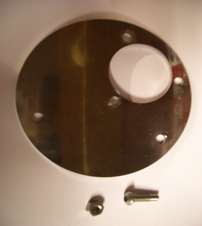

You need to make the plate yourself from 6mm alloy plate.
The hole for the slave cylinder needs to be 43mm diameter & 6 mm from the outer edge.
Once you have it made just offer up the original cover plate with the 3 holes in it and mark it for position of the 3 holes.
Do the same with the cylinder once in the 43mm hole.
I once had a number made & sold them on Ebay but some people just could not understand how to carry out the work & I spent hours on the phone or emailing people........so stopped after that !
1 X PLATE
1 X M6 BUTTON HEAD ALLEN BOLT.
1 X M6 NUT

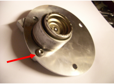

PLEASE ENSURE THAT YOU FIT THE M6 BUTTON HEAD ALLEN BOLT PROVIDED IN THE KIT THROUGH THE PLATE FROM BEHIND AS SHOWN IN THE PICTURE BELOW. IT MUST BE FITTED THIS WAY TO AVOID CONTACT WITH THE CLUTCH CASING.

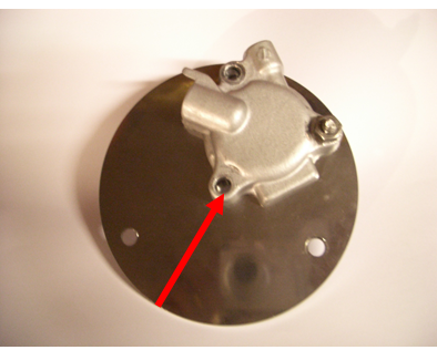

BELOW IS AN OUTSIDE VIEW OF THE PLATE WITH SLAVE CYLINDER FITTED.
YOU WILL NEED TO FIND ANOTHER M6 BOLT TO GO THROUGH THE HOLE THE ARROW IS POINTING TO, AND AN M6 NUT FOR THE BACK.

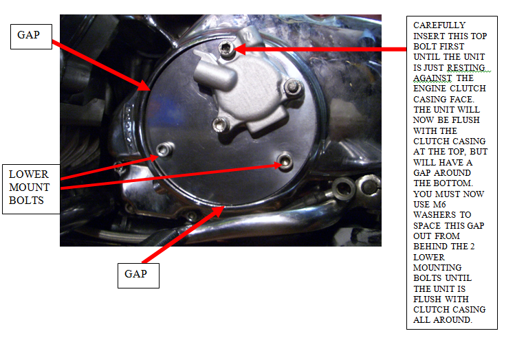

ONCE BOTH M6 BOLTS AND M6 NUTS ARE TIGHTENED, YOU NEED TO OFFER THE UNIT UPTO THE SIDE OF THE ENGINE CLUTCH CASING, MAKING SURE YOU HAVE THE SLAVE CYLINDER DIRECTLY INFRONT OF THE TOP OF THE CLUTCH ADJUSTER BOLT. YOU MUST FIRST REMOVE THE ORIGINAL SMALL CABLE LEVER FROM THE ADJUSTER BOLT AND ADJUST IT AS DESCRIBED IN THE KAWASAKI MANUAL BEFORE YOU FIT THE UNIT.
ONCE THE UNIT IS FLUSH ALL AROUND WITH THE ENGINE CLUTCH CASING, YOU THEN INSTALL THE FLUID LINE, HANDLEBAR MASTER CYLINDER AND BLEED NIPPLE, THEN BLEED AS YOU WOULD A NORMAL BRAKE SYSTEM.
1 X PLATE
1 X M6 NUT
