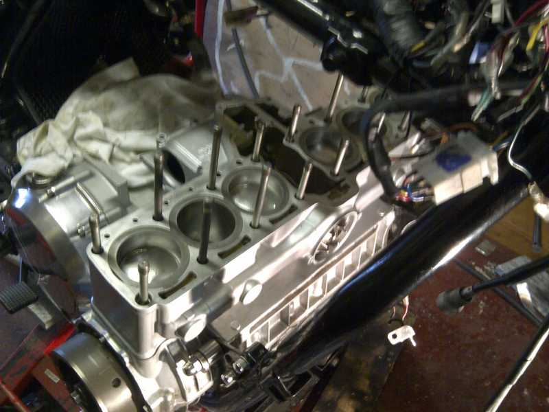

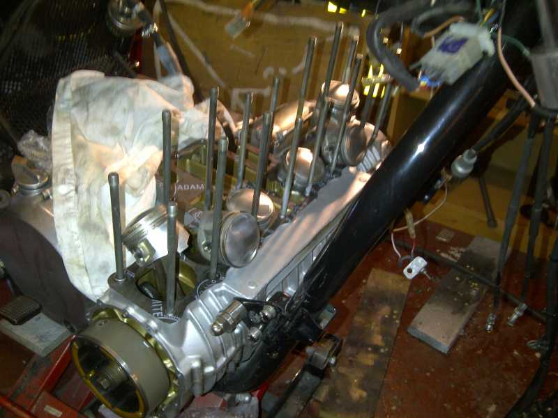

Today is a good day !
I got my top end (cylinder block / jugs) back onto the engine with the new rings fitted.
Many thanks to Dave D (owner of 2 x Z1300's ) and my son Dan for giving up the time & patience to do the work today. It only took 45 minutes to get the whole block back onto the 6 pistons & rings & was quite a straight forward job.
Thanks to all who offered advice on this part of the build as its been 16 years since I did it on a 1300.
This now lets me get onto fitting the head & completing the work.
ROLL ON SPRING / SUMMER 2104 !!
Happy New Year to ALL !!

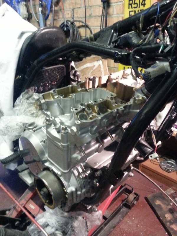

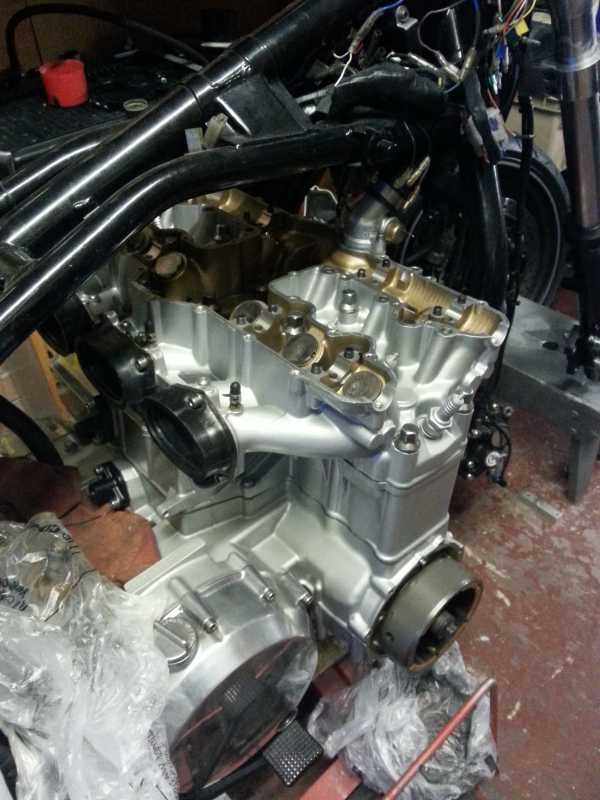

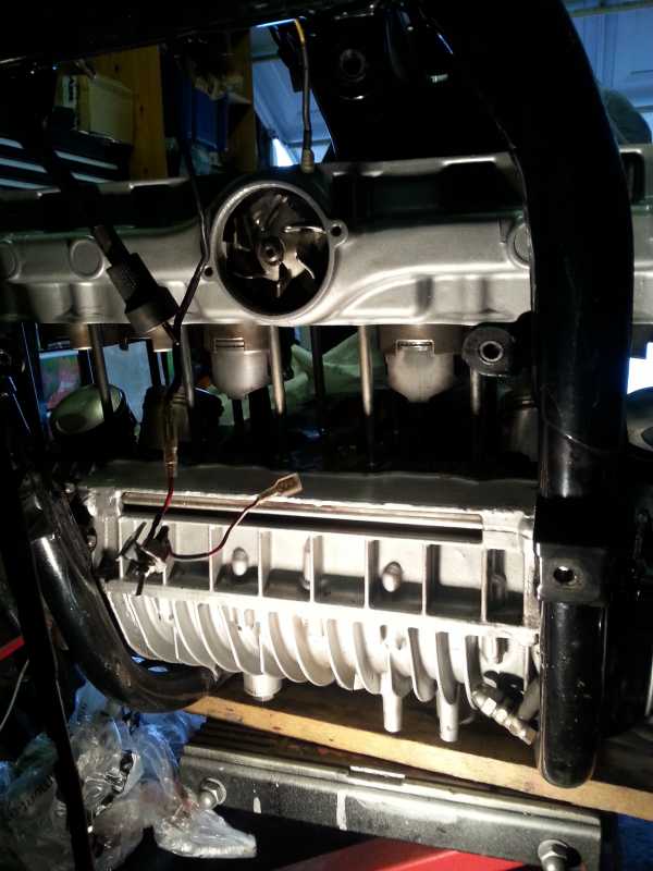

NEW YEARS EVE 31st DEC 2013.
Another great days work in the garage today after Dave & Dans help to get the cylinder block back on yesterday.
Today was fitting cylinder head with water pump & camchain tensioners, carb inlets & torque head down.
All ready for cams & ignition pick-ups next.
Dont think I will be doing any work tomorrow as wont be in any fit state to do much of anything !!

Man, that is a beautiful job you are doing - very nice. I am doing a top end overhaul on my 1300 right now, so these pics are very useful.

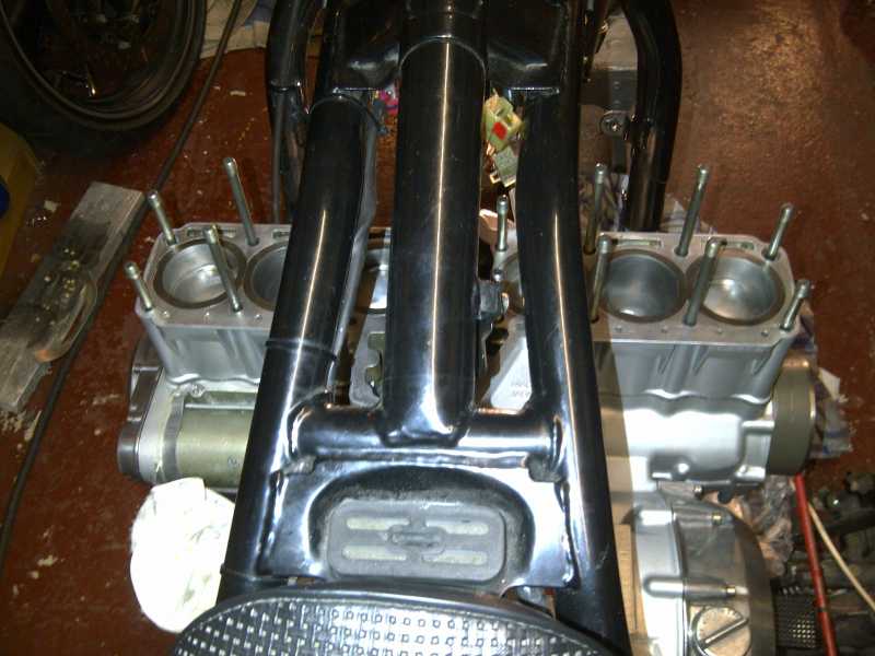

Looking good mate
What's the mesh for between the frame tubes at the rear ...to keep crud off the back of the engine?
