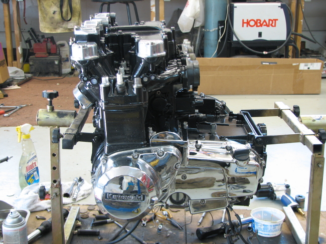

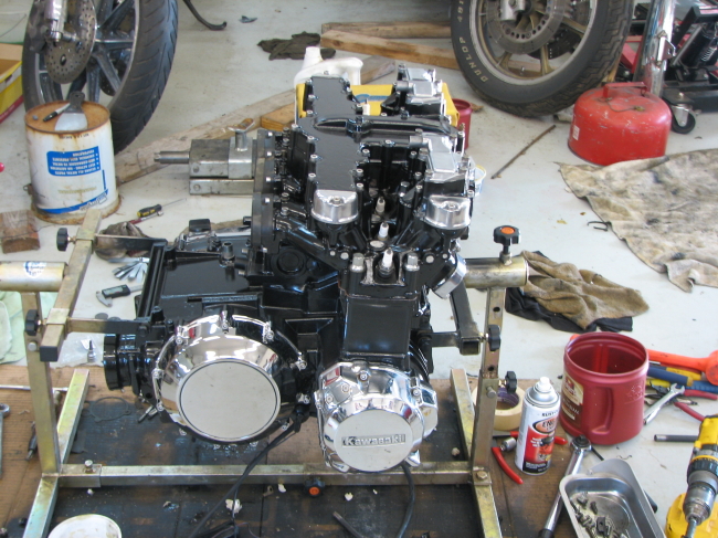

Hello, I like your engine stand, I was going to try to make one. What kind is yours? It looks like it will fit other motors also. Thanks! Bob

Very nicely done!
