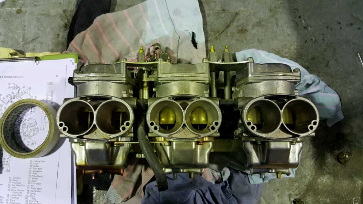

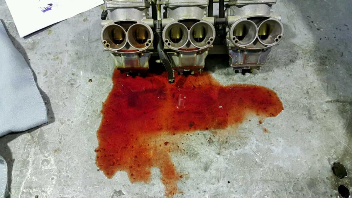

So ripped the carbs off, 2x seem pretty clean but the 3rd has sticky slides. The old fuel that came out was blood red so the next step is to strip and ultrasonic clean all 3x carbs.

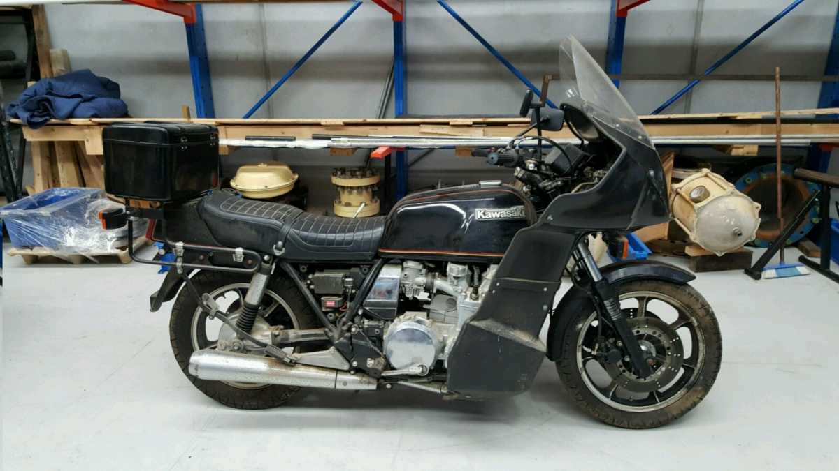

The starting point. I do have both side covers.

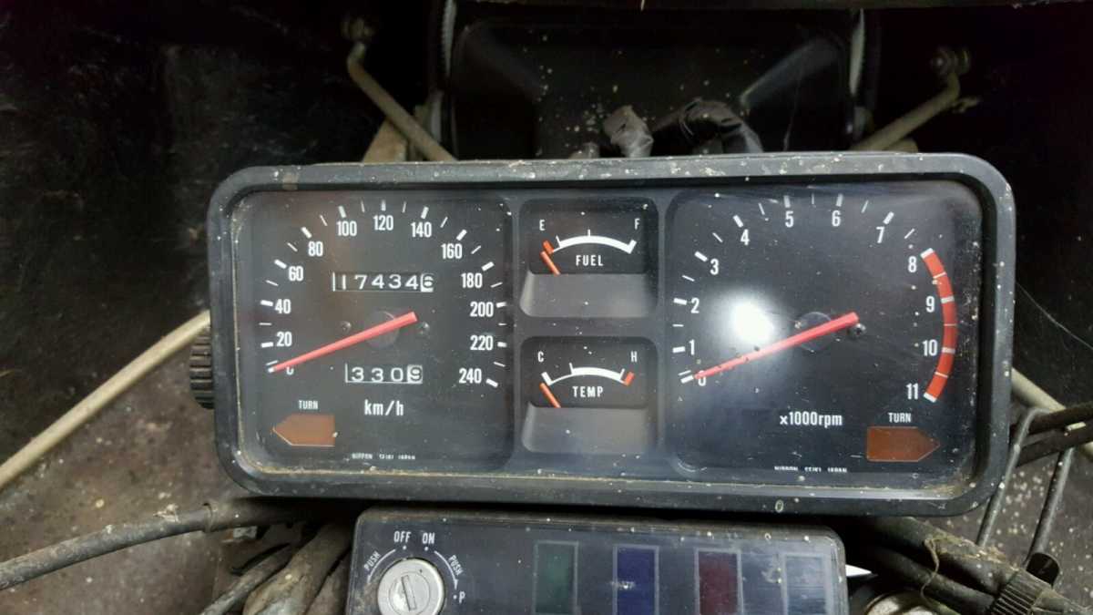

17K kms. Very nice.

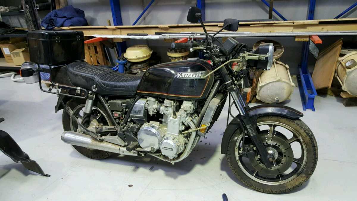

Sans fairing. Much better.

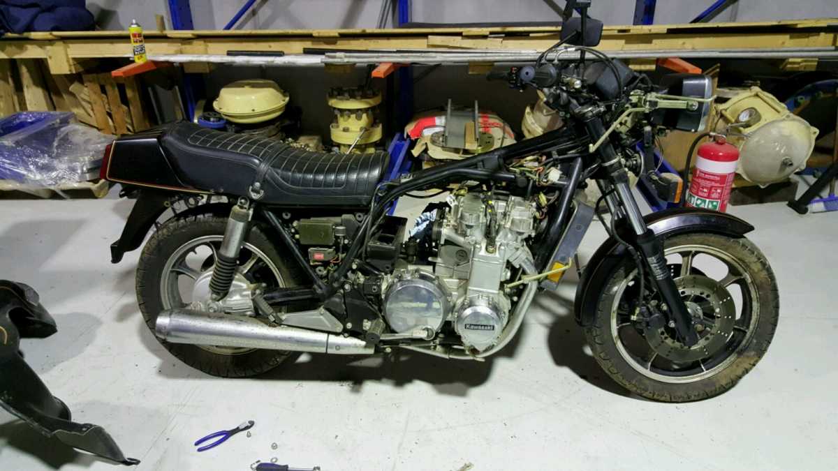

No more pannier rack and carbs out.
Mmmmmmm delicious.......
LH carb is the shitty one.

Looking forward to seeing how you get along. Interesting "red" in the fuel. I wonder if that's what's left after fuel with stabilizer evaporated off??

That Bike is not an A2 or an A1, might be worth you finding out what you got, your IC igniter is telling me this along with the block and no place to mount A1/A2 pickups

well spotted Mark, could be A4 or A5 as it has a large window in the clutch cover.
if the frame Number is between KZT30A-014101 and KZT30A-015900 then its an A4 after that its an A5
