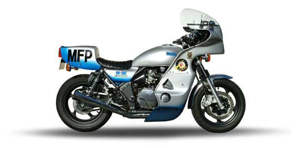

Just looked at the pic with the fairing on and instantly wanted on my bike , Jim Goose and the other Mad Max Zd's made them totally iconic...I want it..but you're in Oz, where it should be

10 years 1 month agoTyler wrote: Good job getting some fire in those cylinders again!
That fairing is actually a pretty nice piece of kit, any info on who made it? I would keep each and every bit of the that fairing and it brackets if it was a special order for the 1300.
Interesting to note about your '81 A3 being made in the US, I have an '81 A3 with an earlier vin date, made in Japan.
I am convinced the A3 was stop-gap model to keep production moving until the real changes were finished to the A4 in '82. I think Kawasaki had too many changes to fix the shortcomings of the 79-80 years and could not source the parts, or finish the design work in time.
The A3 made the mechanical changes to the engine, but they some how new the ignition was not going to work out long term. It's so different from the bikes before and after the A3... and the changes to fit the new ignition 82 were not minor (the engine cases are different).
The A3 is quite the odd ball that's for sure. Anyone know who many A3's were made? the internet claims less than 800 but I have no proof of that.
The fairing is a La Parisienne. It is definitely made to suit the Z1300. I'll be hanging onto the fairing/mounts/etc, wont be putting them back on though, I like em naked!
