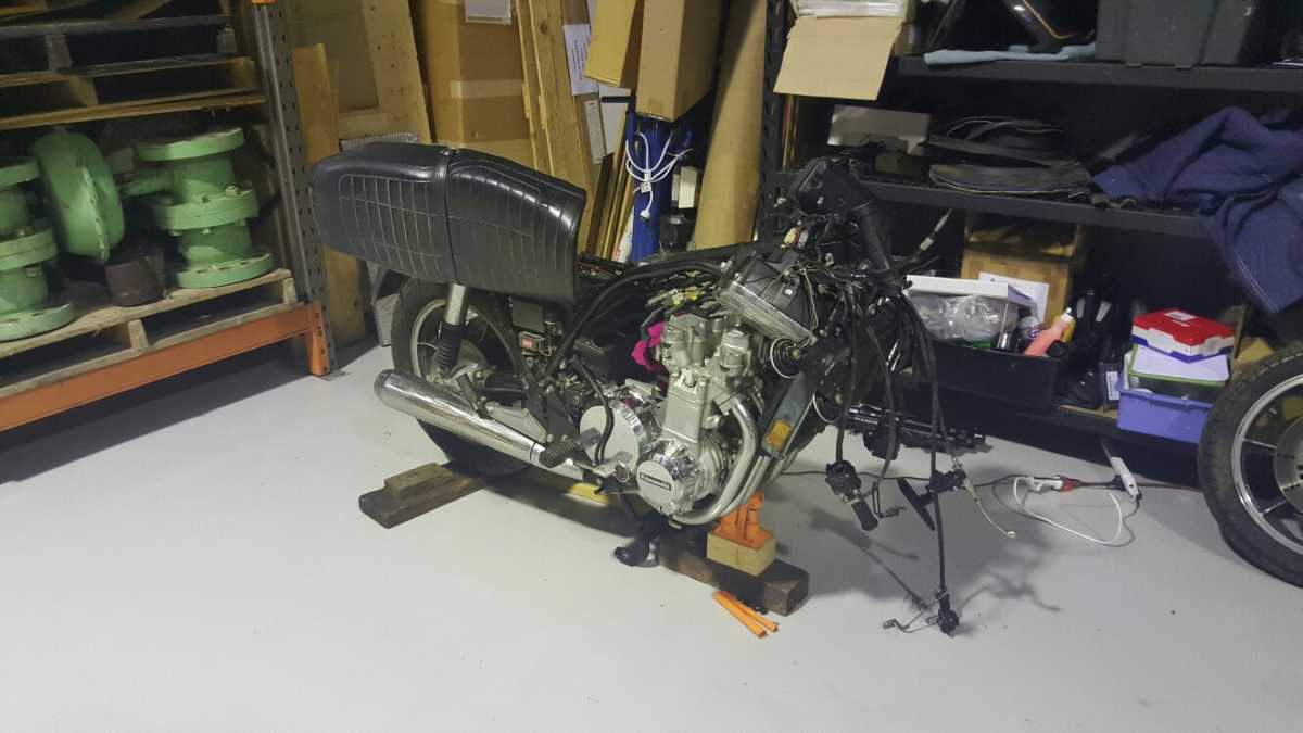

Finally getting some work done.
Front end is off. Headstem is out for new bearings and seals.
Forks to be rebuilt as well as brakes.

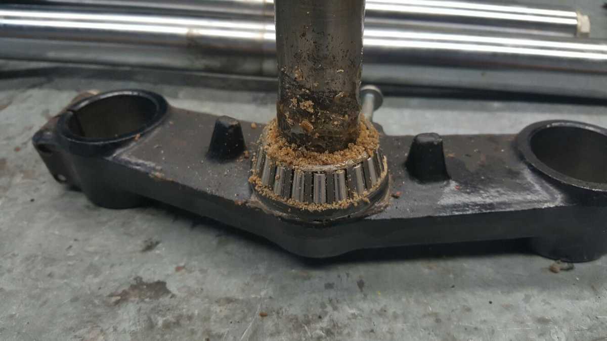

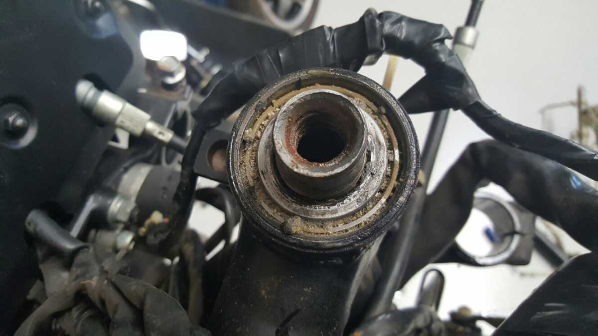

Some pics.
The delightful mess that was the headstem bearings. Had to grind the inner race off that bottom bearing.
Gotta grab some fork oil so i cn rebuild them legs and put the front back on, plus get a valve cover gasket.

Oh yeah. Had to grind off some tabs on the steering lock. They had welded extensions on them, i assume to restrict movement so it didn't foul on the LaParisienne fairings.
