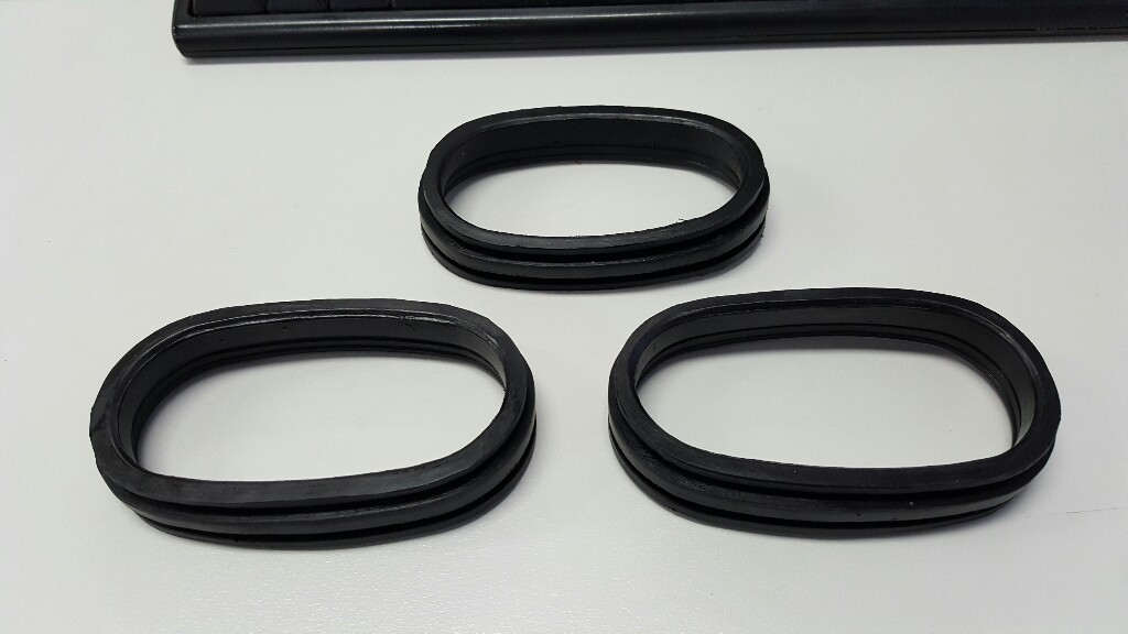

Ok. I can start making progress again.
New airbox boots from z1300.de
Now to get the inlet assembled and start on something else.
