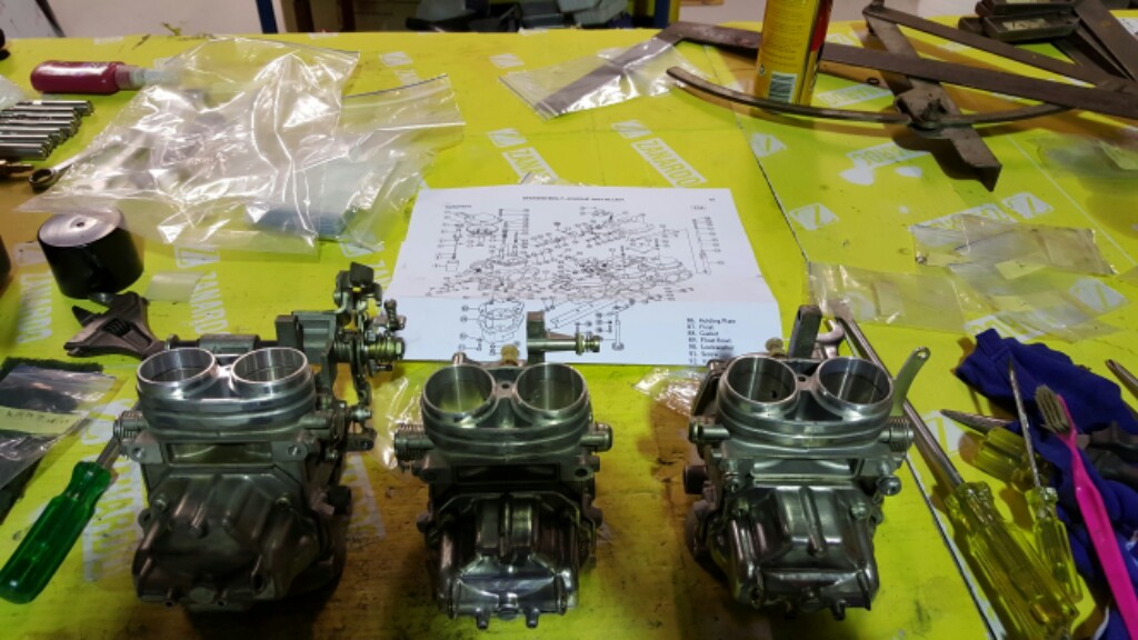

Started on carbs last night.
In good nick internally just plenty of the red sticky shit gumming everything up and crap in the bowls.
2 down, 1 to go.
Ultrasonic ended up a nice colour.....

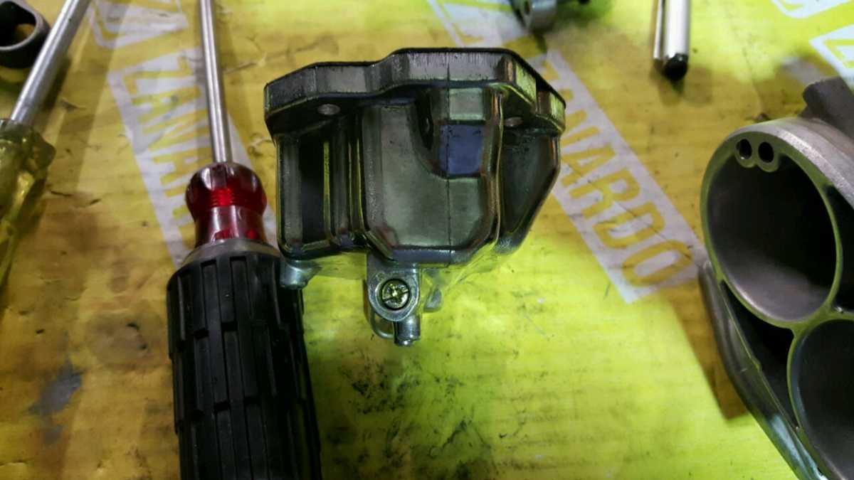

Any thoughts on how to extract this without destroying it? Is jammed in super tight.
Also will need to clean out the fuel solenoid as its full of sticky red goo too.
If it's still functional should I keep it or remove/replace?
