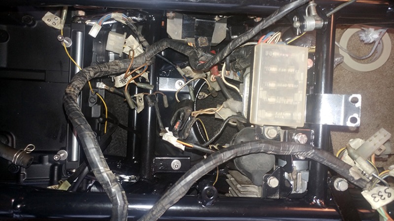

I am putting back the electrical system, which was quite a mess when it came with the bike. All lights and signals missing, some cut wires and lots of loose stuff. I'm trying to find the correct placement for everything (don't mind the few brackets with paint coming off - that will be taken care of once I have all components sorted out and hooked up; easy to beautify the subcomponents even one by one).
I need information about which way to feed the main bundle and the branching bundles (in the photo). If I am correct it has to go underneath the battery tray and the connections are made between the battery and the rear inner fender.
There is a hook/loop underneath the center frame cross bar. The harness is supported going through this, right?
If anyone could post a few pictures showing the way the wires go, it would be most helpful and appreciated!

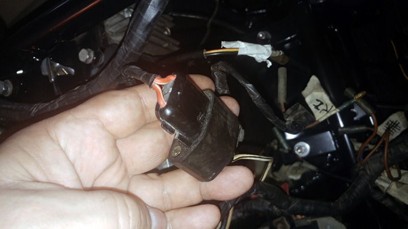

I can't find a place where to attach this component... Where does it go?

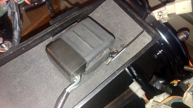

Also, this I can trace following wiring, but same as above, I can't find anywhere where it would attach.

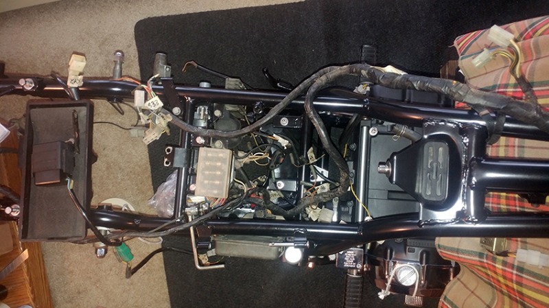

I might be missing a bracket in this compartment... If you can spot and make a suggestion, please do so! I can post more bigger photos taken from different angles
