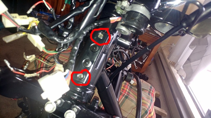

Hi Stan, the oil level "controller" could be located on the left hand side behind the main switch cover. But i only know this from the picture i once found on E-bay. Hope it helps.

I don't have this triangular bracket.. Maybe it's a different year and model. I can't see where I could bolt down the one I have, but I will improvise something.

Ok Stan. Several things here.
1. The wiring loom I have does not match the Canadian bikes diagram in the manual. So its not much use a t this point.
2.I have taken a number of photo's yesterday and after seeing the post by zed-thirteen- that maybe is better way to go where you post a question along with photo's and then I can go and look at my bike and photo back- maybe the next day.
3. You appear to have the main loom which terminates in the headlight. Do you have the headlight bucket and the corresponding connections that go inside it . The easiest way to decide is matching male and female connectors and the corresponding wire colours going into and out of both.
4. The main loom runs underneath the main frame member and is held in place by a bracket and nut and bolt set-up welded to the frame member. Here's a photo.
