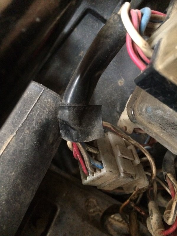

One of the main 'mysteries' I need to solve is how the harness goes around the battery compartment. The main harness splits into two smaller harnesses.
Do they go above the air boxes and filter, or below? One, a thinner one, I am sure goes around it. But the thicker one, the one connected to the fuse box and then branches off to the tail light and the rear turn signals - does it go underneath the battery tray?

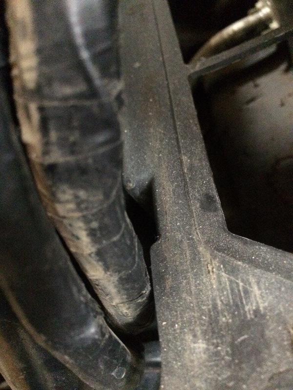

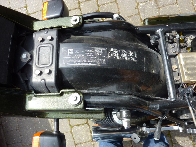

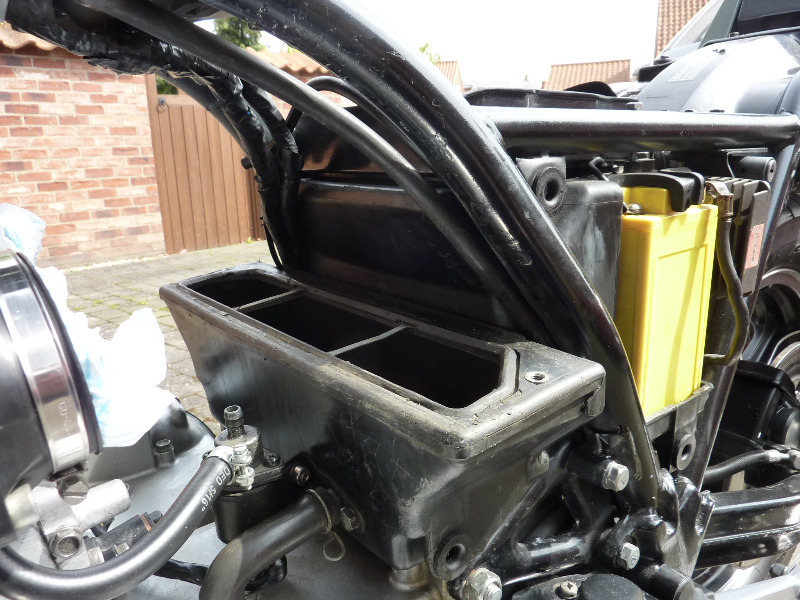

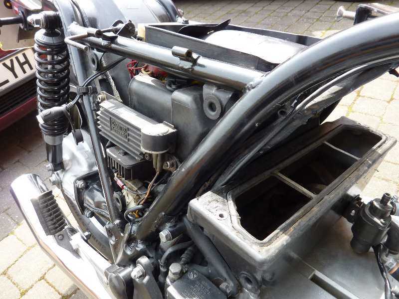

8 years 2 months ago - 8 years 2 months agoStanding on the righthand side of the bike with the side cover off. The main harness runs under the main frame member , then follows the right side frame tube thru the small cut out in the airbox as shown in the photo. To the left of the wire harness is the frame down tube - right side of bike.
It then goes under the battery box to about 5 different plug connectors. A small harness splits off out towards the tail light. The main harness goes upto the fuse block
In the background is the battery box, in the foreground , the vertical vanes , is the rectifier.

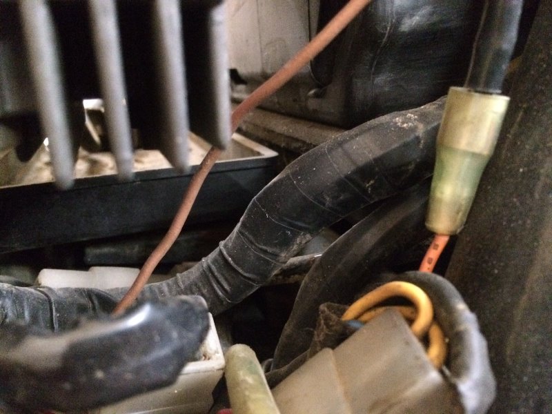

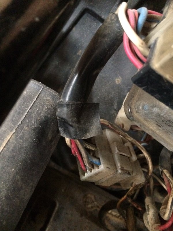

Stan. I previously took a few pics when I was testing my igniter - not sure if it helps but it shows the routing of the main harness around the RH side of the airbox.
Cheers Tim
Cheers Tim

Tonto, this greatly complements what I have seen. Thank you man!
