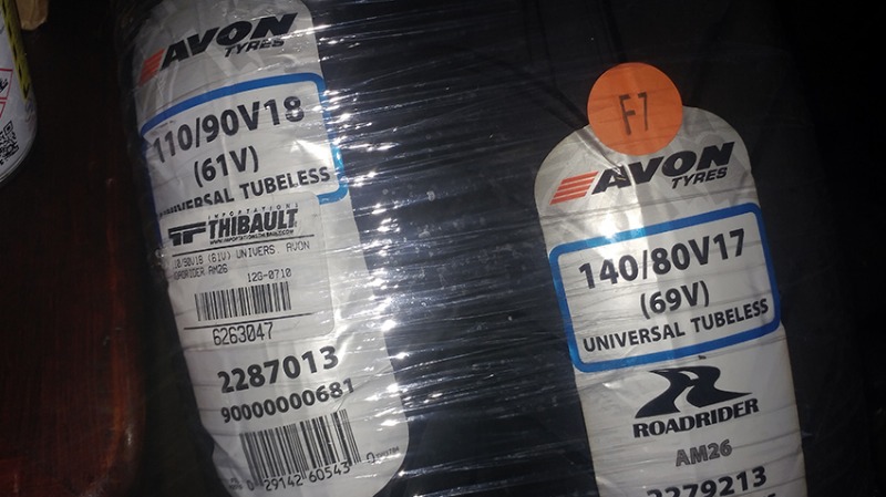

Another day today. It's good to get away from this project for sanity.

It'll be nice to see those mounted, Stan. Are you going to fully assemble the bike before returning it to ground level? I just wondered how you are going to get it in the lift at your apartment.
