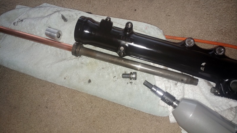

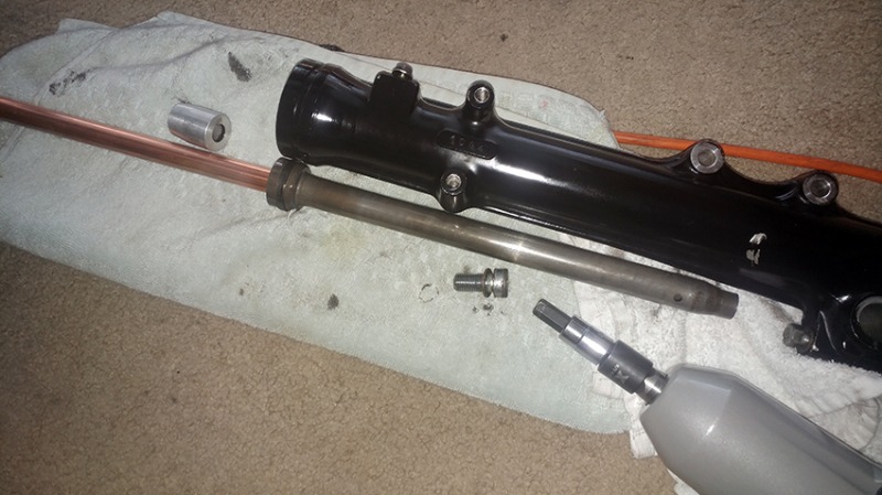

So, I bought 3 feet of 1/2 inch diameter copper pipe. Tapped it into the fork and it worked (held it with vice-grips)
Now I can see what's going on, and the suggested making of your own tool using a nut and a steel rod would be the way to go. Next will be a visit to a hardware store to get them, and a welding shop for a quick weld.
