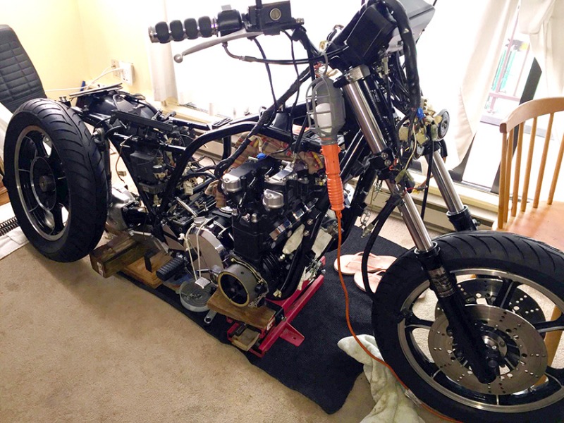

Tires mounted! Need those forks done as well!! The only thing holding me back will be the electrical system and fuel system.
