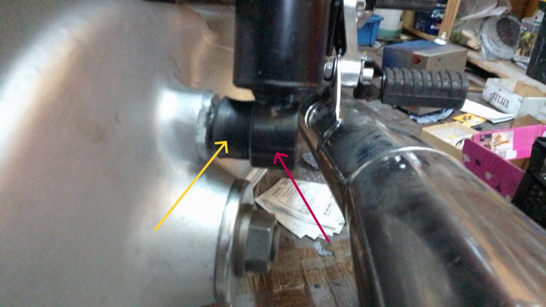

Regarding soft suspensions like a jelly dessert, I think it will help solve part of the problem if I put the eye of the shock absorber back in its silent block, installing a washer will help me keep it in place.
