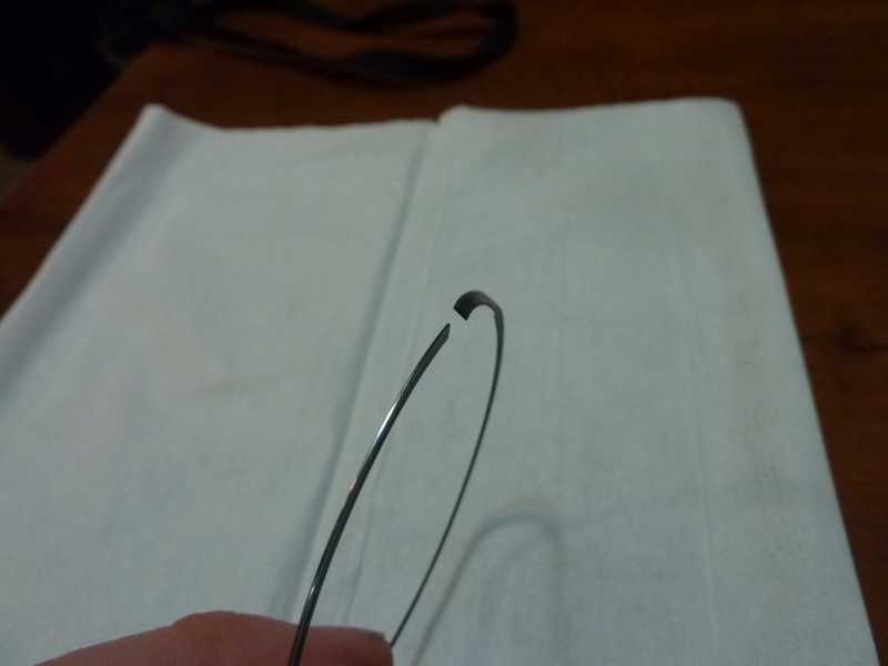

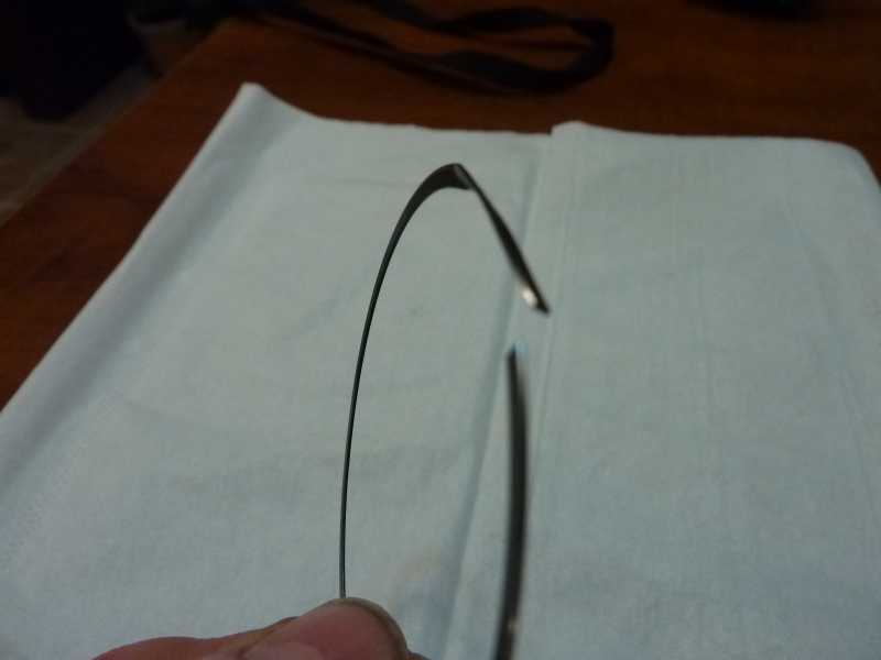

The piston to bore clearance was the only measurement my machine shop seemed concerned about also. Each piston was numbered for each bore. Nothing about the rings.
Misery needs company. Last oil ring of last piston- damn!
Wonder if it can be straightened ?

trying to straighten that would be asking for trouble down the track and not very far down the track either.

You are right Rick- after sleeping on it, wisdom has prevailed.
$60.00 for a complete new set from Japan is not so bad- just the time it will take.

I can send you a set of oil rings if you pm me your address
No point two of us buying a complete spare set of rings.
