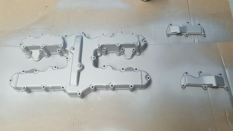

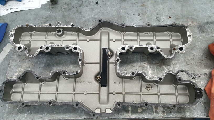

Finally got a few hours to myself and finished off the APE cam tensioner install using Kawboys instructions from earlier in this thread.
Was pretty easy but swear you need double jointed kids hands to get at the coil mount nuts to get the cam cover off.
Still waiting on cam cover gasket to arrive so i can reassemble, also gave the covers a lick of alum VHT.

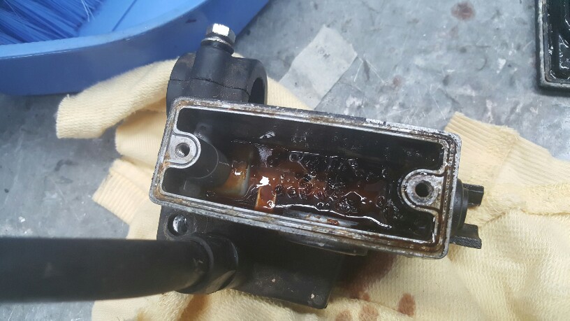

Also started rebuild of front MC. Pretty ugly.
Soooooo clean inside. Couldn't believe it.

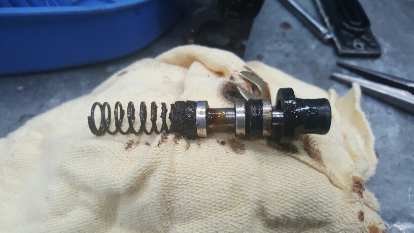

Mmmmmmm, chunky.
More of the same.
Bit cleaner now, still needs a good run through the ultrasonic and fresh seals.

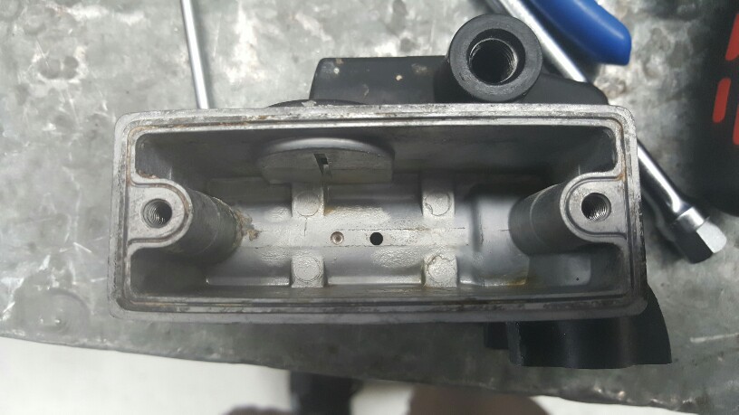

Is the hole on the LH side blind or a through hole? I didn't have any fine enough wire handy to check.

That hole is necessary or the pressure builds up and clamps the calipers to the disc as the fluid heats up.

Just to clarify, this is the hole I was talking about. Can you confirm that this is a through hole as well?
