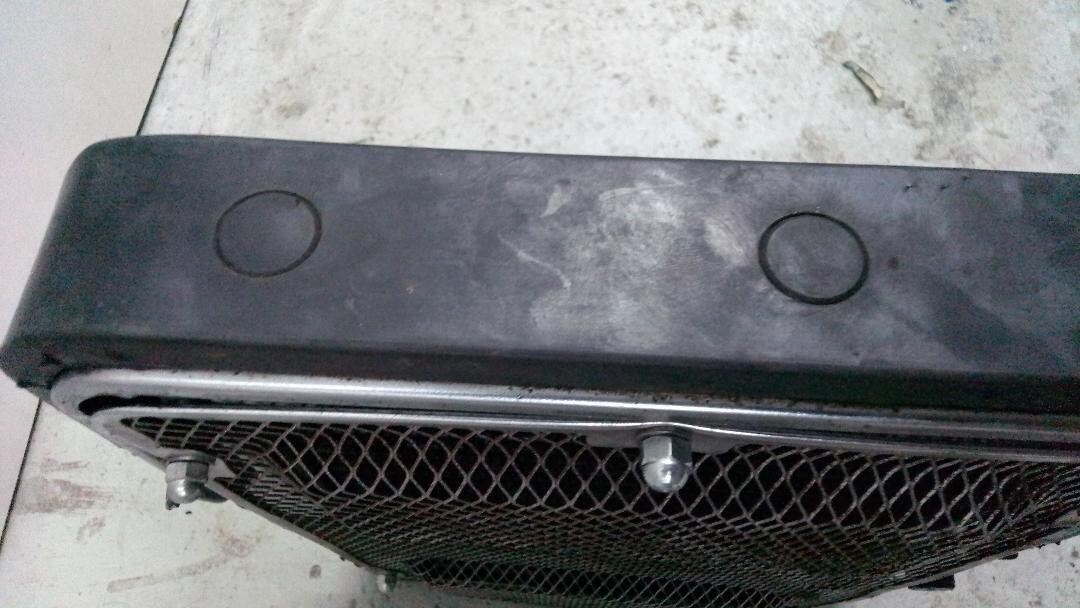

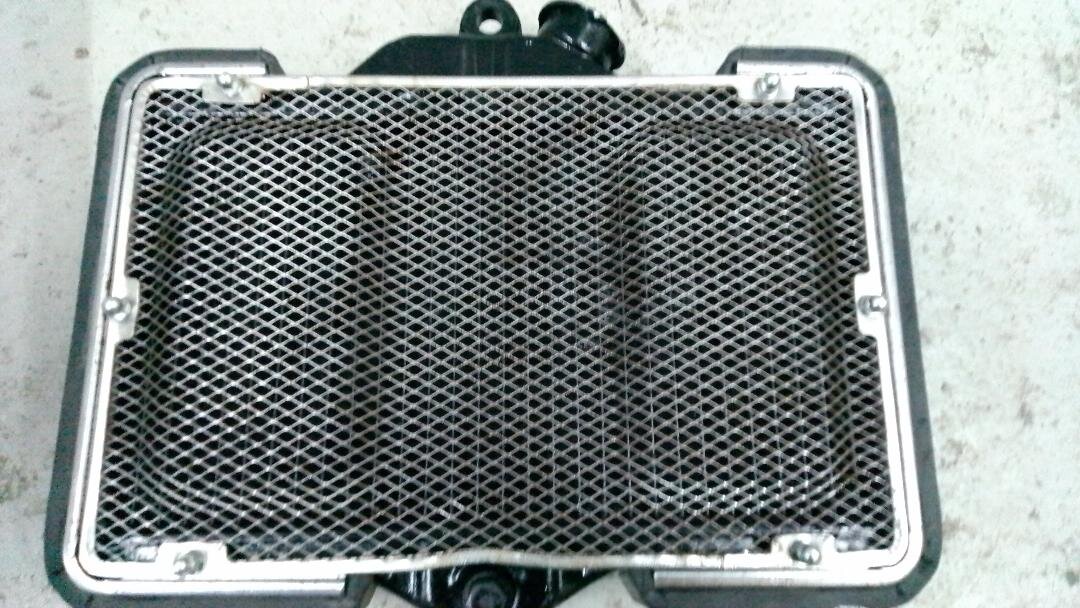

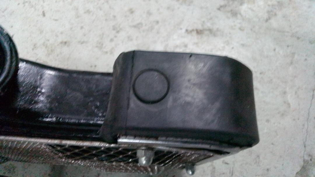

I returned to the garage with Christine to continue assembling parts, this time the radiator.I bought the side protectors and the front grille from a French scrap dealer, the truth is that he sent me the complete kit, with its protective screw caps, the money works miracles.

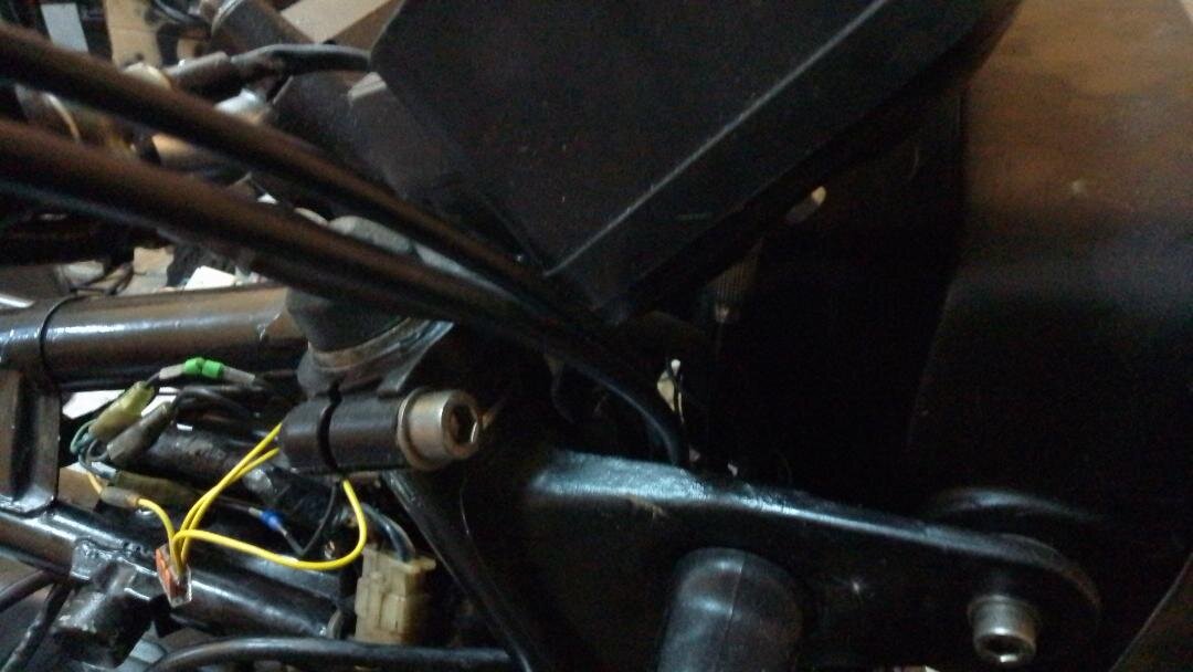

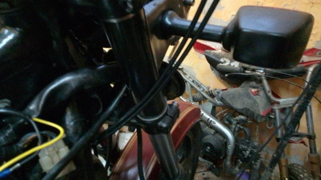

The bad thing about having disassembled something months ago is the lack of memory when it comes to remembering small details, that's how I had the accelerator cables mounted until I realized that turning the handlebars to the right imprisoned them against the chassis.
I have had to re-disassemble the heads of the carburetor housing cable covers to reroute the line to its corresponding place.
Finally it was time to test everything, pending the installation of the tank and side covers.
The bike sounds much better live than in the video.
